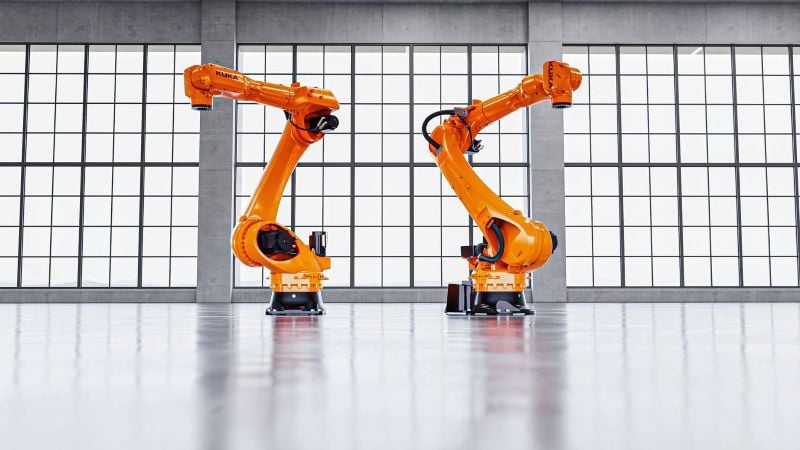

The new KUKA IONTEC ultras have a payload range of 80 to 120 kg and a reach of 2,300 to 2,700 mm.
The new KUKA IONTEC ultras have a payload range of 80 to 120 kg and a reach of 2,300 to 2,700 mm. Image used courtesy of KUKA

The new KR IONTEC ultra industrial robot occupies only a small space, considering its capability. With a lift capacity of 80 kg to 120 kg and a reach of 2300 mm to 2700 mm, the new robot rounds out KUKA’s robotics catalog. It bridges the gap between medium and large-capacity lifting robots, fitting in compact robotic welding cells. In terms of the KUKA catalog, it has a smaller footprint than KUKA’s QUANTEC line of robots, with little loss of lifting capacity.

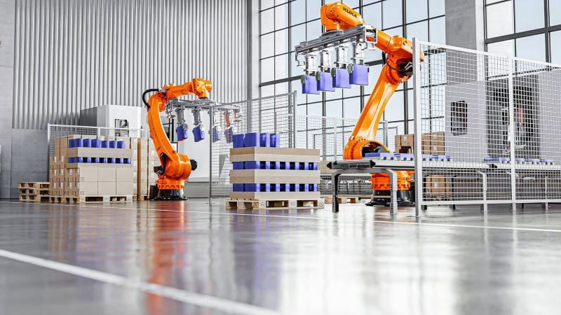

The KR IONTEC ultra can be used to perform spot welds by attaching a lightweight welding gun, move battery clusters with the proper grip, and perform numerous other tasks. The automotive sector, particularly the electric vehicle (EV) market, will especially benefit from this versatile robot.

The new KUKA IONTEC ultra is particularly suited for use in handling and spot welding
The new KUKA IONTEC ultra is particularly suited for use in handling and spot welding applications. Image used courtesy of KUKA
