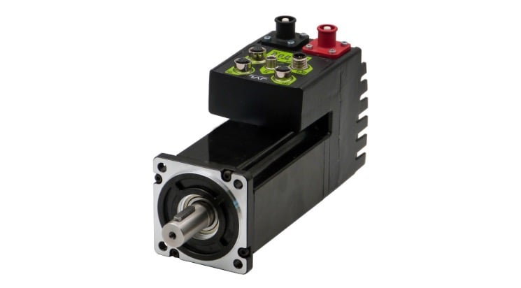

JVL has expanded its long-running MAC motor platform with a new 1500-watt integrated servo designed for 48-volt DC systems. The MAC1403 represents the next step in the company’s cabinet-free motion architecture, a design philosophy that folds the drive, controller, encoder, and communication hardware directly into the motor housing. For machine builders working within tight footprints or thermal constraints, this type of all-in-one architecture offers an alternative to cabinet-based servo systems without sacrificing performance or industrial-grade networking.
The MAC1403 continues the core MAC concept: every major control element is built into the motor. Instead of separating the drive hardware, PLC interface, and networking equipment into a control cabinet, the unit integrates them internally. This structure gives designers more freedom to scale multi-axis systems without increasing cabinet size, and it reduces the wiring required to get a machine running. For applications where cabinet space, heat density, or installation labor are limiting factors, the integrated format changes the way systems can be laid out.
JVL’s new-generation MAC1403 integrated servo motor combines the motor, drive, controller, and encoder in one cabinet-free unit.
JVL’s new-generation MAC1403 integrated servo motor combines the motor, drive, controller, and encoder in one cabinet-free unit. Image used courtesy of JVL
