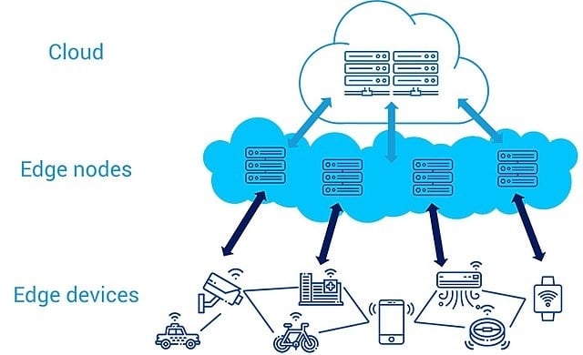

An edge computer is a PC that acts as a gateway between two devices, such as a PLC and a server. PLCs typically cannot communicate directly with data collection servers until the software that allows direct or cyclic messaging over an industrial protocol is installed. An edge computer is a small PC that has this software or drivers installed to allow data from a PLC to be extracted and stored in a database. The edge computer might have a database for short-term data storage, with the expectation to push all data out to an IT server. This topology allows machine builders to provide their customers with standard database access to their data without interfering with the automation controllers.
Layout of how edge computing works.
Layout of how edge computing works. Image used courtesy of Wikimedia Commons
