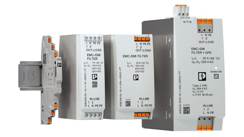

Phoenix Contact has launched the FILS-1S, SFP2, and TTC-6-SFP series of EMC filters
Phoenix Contact has launched the FILS-1S, SFP2, and TTC-6-SFP series of EMC filters. Image used courtesy of Phoenix Contact
Three New EMC Filters
The three new families of EMC filters are designed to filter out disruptive electrical noise in both AC and DC circuits. The FIL-1S series of EMC filters is designed for high-frequency interference. The filters utilize a metal housing and an additional PE terminal for detecting interferences between the active wires and ground. The FIL series supports a nominal load current of 1 to 20 A at 230 VAC.
The SFP2 series of EMC filters not only protects devices from electrical noise but doubles as an overcurrent device, protecting both the input and output sides of the filter. This series includes variants that are UL recognized and features a nominal load current range of 5 to 20 A.

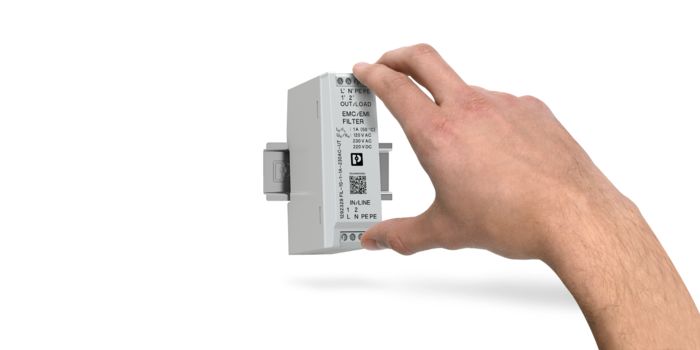

The 6.2 mm wide TTC-6-SFP-24AC-PT EMC filter designed for high-frequency noise and surge protection
The 6.2 mm wide TTC-6-SFP-24AC-PT EMC filter designed for high-frequency noise and surge protection. Image used courtesy of Phoenix Contact
When panel space is a concern, the TTC-6-SFP series of EMC filters offers high-frequency protection in a compact 6.2 mm wide package. This filter is designed to keep unwanted noise out of digital communication systems.
