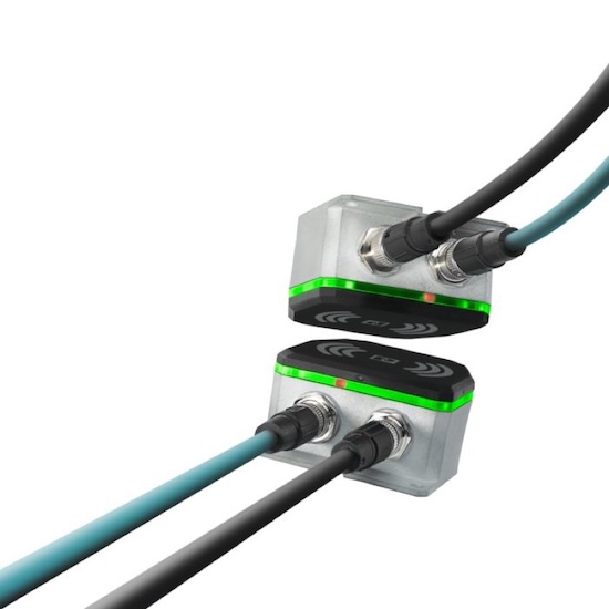

Power is transmitted inductively, with a single NearFi pair capable of delivering 50 watts. Using two pairs in parallel increases the total power to 100 watts with automatic current balancing. Depending on the application, the system can also supply two electrically isolated 50-watt power rails. Because there are no exposed contacts, NearFi is highly resistant to dust, vibration, and mechanical wear. The couplers are housed in IP65-rated enclosures and use standard M12 connectors for Ethernet and power, making installation straightforward and reliable even in harsh industrial environments.
Flexible mounting and simple setup
The NearFi couplers do not require precise alignment. They can be installed facing each other directly, at an angle, or even with some lateral offset. The system is also tolerant of rotation, which opens up many possibilities in applications with moving equipment. This flexibility reduces mechanical design constraints and makes integration easier.
The system consists of a base unit and a remote coupler. No programming or configuration is needed. Once powered, the couplers begin communicating automatically. Bright LED indicators around the housing provide 360-degree visibility for alignment and diagnostics, helping technicians verify operation at a glance.

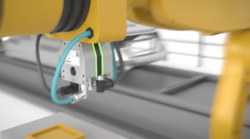

NearFi is particularly effective in automation environments where components move constantly. Robots that perform frequent tool changes, rotary indexing tables, and AGVs all benefit from its contactless design. These are the applications where cables wear out, slip rings need frequent replacement, or connectors become unreliable over time.
In a robotic setup, NearFi makes it possible to send power and data to a rotating tool head without the hassle of physical connectors. This eliminates common failure points and simplifies maintenance. For automated guided vehicles, NearFi provides a reliable way to exchange data with docking stations or production equipment without the wear and tear that usually comes with traditional wired connections.
The NearFi coupler can be used for automatic tool changes in robotic applications. Image used courtesy of Pheonix Contact.
