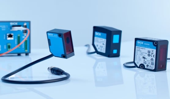

Laser displacement sensors often falter when faced with glossy metals, uneven plastics, or poor lighting conditions. SICK’s new OD200 is built for fast, stable, and precise short-range measurements on surfaces that may be difficult for other sensors to detect. The OD200 is a practical, easy-to-integrate option for industrial environments where accuracy and reliability are critical for running processes smoothly.
OD200 sensor delivers high-speed, micron-level precision on challenging surfaces where other displacement sensors fail.
OD200 sensor delivers high-speed, micron-level precision on challenging surfaces where other displacement sensors fail. Image used courtesy of SICK
The OD200 combines a newly developed triangulation core, an advanced dynamic receiver, and optimized optics to deliver repeatable, micron-level precision across a wide range of surface types. Its compact design and support for IO-Link, analog, and digital outputs make setup quick and integration straightforward, while still delivering the fast, stable performance needed for tight-tolerance applications.
