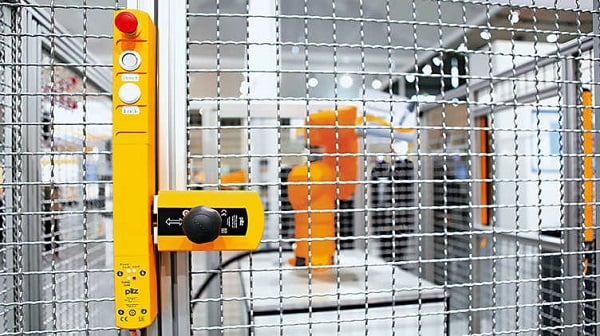

Example of a safety gate locking system
Interlocking secure gate safety system in action. Image used courtesy of Pilz
