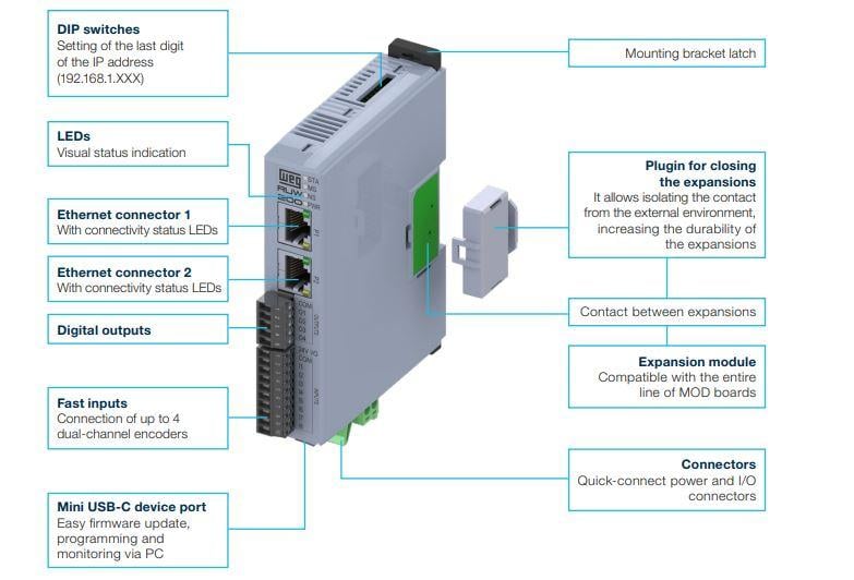

The RUW200 is built with a modular book-style format that allows users to add up to eight I/O expansion boards, supporting everything from digital and analog signals to thermocouples, RTDs, and even load cells. Each board is just 25 mm wide, helping save space inside industrial panels.
Expansion is plug-and-play, meaning no specialized wiring or programming tweaks are required when adding new modules. A protective plug-in closure shields contact points from environmental contaminants, helping extend hardware longevity even in harsh industrial settings. Quick connectors for power and I/O simplify cabling and make it easier to scale on the fly without extended downtime.

With two built-in Ethernet ports, the unit supports EtherNet/IP and Modbus-TCP stock, allowing it to communicate effortlessly with virtually any industrial controller on the market. A simple DIP switch on the unit lets users configure IP addresses directly, speeding up deployment and reducing the chance of errors.
The RUW200 provides multiple benefits, ranging from plug-and-play expansion to scalable remote I/O.
The RUW200 provides multiple benefits, ranging from plug-and-play expansion to scalable remote I/O. Image used courtesy of WEG

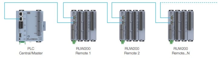

These remote units can be daisy-chained and distributed throughout your automated process to connect your sensors to a centralized controller.
These remote units can be daisy-chained and distributed throughout your automated process to connect your sensors to a centralized controller. Image used courtesy of WEG
