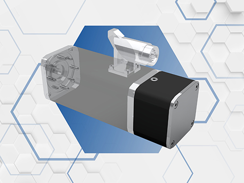

Dunkermotoren, a brand owned by AMETEK, has released a new high-precision magnetic encoder called the MR 38. The MR 38 encoder is small and useful for tasks where positioning needs to be exact. It can track movement accurately with its 1024 pulses per revolution on outputs A and B, making it suitable for tasks that require complex motion.
The new motor encoder from Dunkermotoren features a compact design.
Dunkermotoren’s new MR 38 magnetic encoder features a compact design and precise positioning capabilities. Image used courtesy of Dunkermotoren
High-precision Capability
The MR 38 features an Index Signal, which acts as a reference point for the motor's movement. The Index Signal helps ensure that the data transmitted by outputs A and B is accurate, providing enhanced safety and reliability. Each full motor rotation is divided into 4096 steps, allowing for precise control of positions with an accuracy within millimeters. The encoder can reliably transmit data with its 20 mA output current, and the encoder’s signals can be inverted to improve resistance to interference.
Users can choose between an encoder that operates on a 5 VDC or 24 VDC power supply. The MR 38’s compact size allows it to seamlessly integrate into the housing of Dunkermotoren's small BLDC motor series. This integration simplifies wiring by enabling a one-cable solution, reducing material requirements and saving space, especially in applications where space is at a premium.
