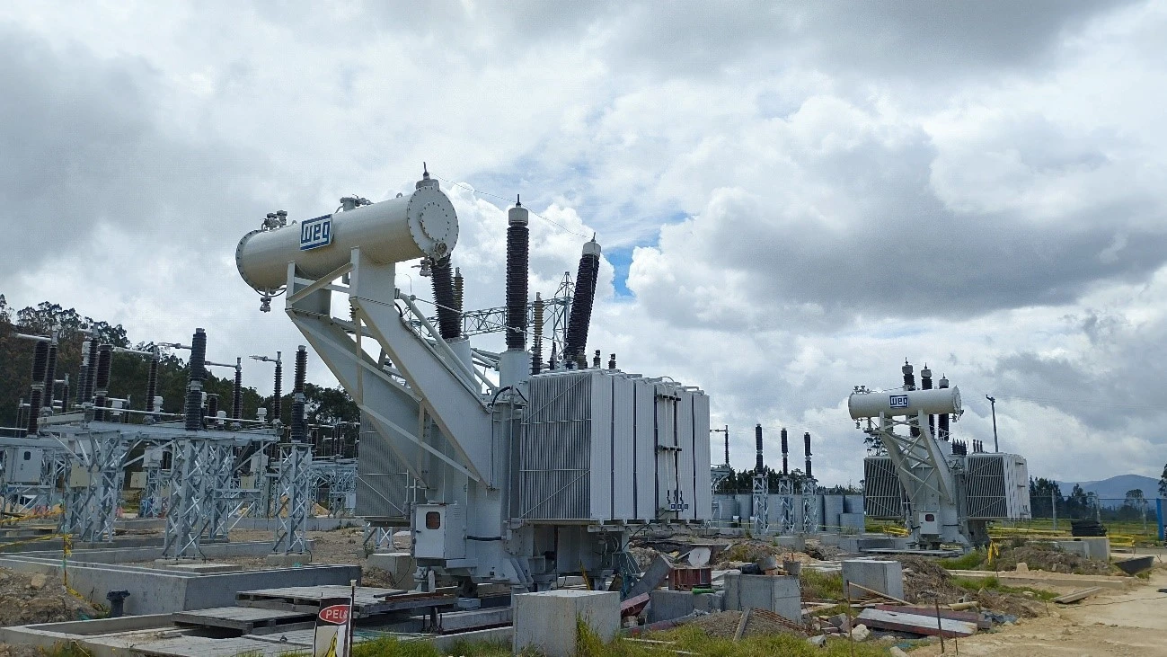

Current construction at the Canoas Wastewater Treatment Plant.
Current construction at the Canoas Wastewater Treatment Plant. Image used courtesy of WEG

After a competitive bidding process, WEG will engineer and supply several substations, as well as transformers, motors, and other gear to support the electrical requirements of this mega project.
More specifically, WEG will supply a 115 kV complete substation. The substation is to include two 30 MVA/115/13.2 kV transformers and is expected to improve plant reliability and reduce downtime. WEG will also supply 17 sets of medium-voltage switchgear, as well as low-voltage load centers as part of the electrical end of this contract.
In terms of pumping capacity, WEG is to supply six 4300 kW 3-phase induction motors, as well as variable frequency drives for each motor. Capable of pumping 6.4 cubic meters of water per second to a height of 51.4 meters, the motors mount vertically to save space.
