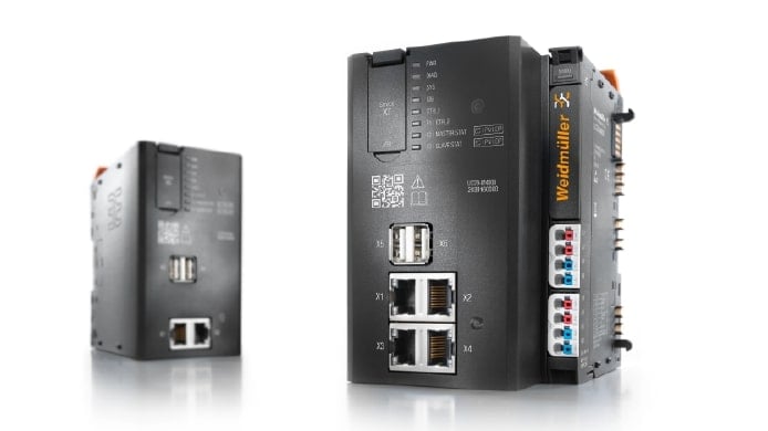

Weidmuller’s PAC controllers run the u-OS software for processing data locally
Weidmuller’s PAC controllers run the u-OS software for processing data locally. Image used courtesy of Weidmuller
