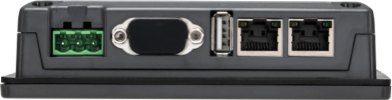

Dual Ethernet for IT/OT Integration
The cMT2058XH (W) comes equipped with two Ethernet ports with LAN1 supporting speeds up to 1000 Mbps and LAN2 offers speeds up to 100 Mbps. This setup enables users to isolate OT and IT networks, connect multiple subnets, and link additional devices without needing external switches. Additionally, a USB 2.0 host port provides compatibility with peripheral and data logging applications.
The cMT2058XH (W) HMI features USB 2.0 and dual Ethernet ports
The cMT2058XH (W) HMI features USB 2.0 and dual Ethernet ports. Image used courtesy of Weintek
