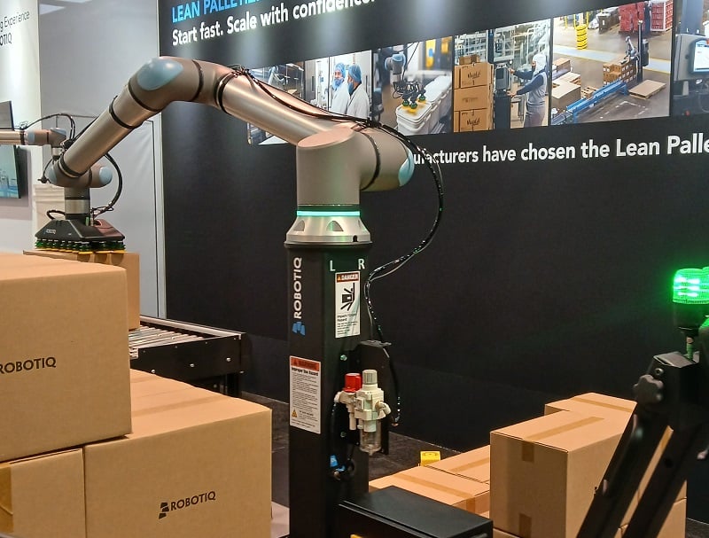

 Figure 1. A mobile robotic palletizing solution, designed for quick changes in production. Image used courtesy of Control.
Figure 1. A mobile robotic palletizing solution, designed for quick changes in production. Image used courtesy of Control.com - Robotiq at a trade show
When programming the system, it is important to consider intervals in which the system will experience downtime in productivity and use that time for other tasks. For example, if the robot has placed all the products from the feed system, it can use that downtime to place a slip sheet on a pallet that needs one.
The most efficient way to do this would be to wait until there is a lag in the product before placing the slip sheet, to keep the system from backing up on the other lanes.
T-cart systems allow for the robot to stack multiple lanes of product simultaneously. When dealing with a system with a T-cart, programming should keep downtime to a minimum and stage pallets in order to avoid delays.

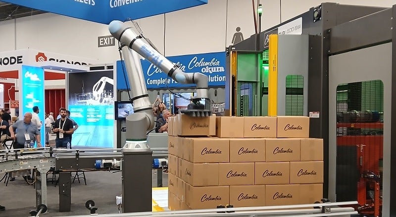

  Figure 2. Robotic palletizing involves customized grippers for individual boxes and packages. Image used courtesy of Control.
Figure 2. Robotic palletizing involves customized grippers for individual boxes and packages. Image used courtesy of Control.com - Columbia/Okura at a trade show
With an HMI, the system offers more flexibility in the way it can stack products. It allows for versatility in the types of products moved simultaneously through one lane. The operator can simply type in updated product dimensions, the number of layers, and slip sheet placements, as needed.
The robot can then offset its pick and place positions to match the box changes, allowing for a much more versatile system. With this arrangement, future products can easily run through the system with little interference.

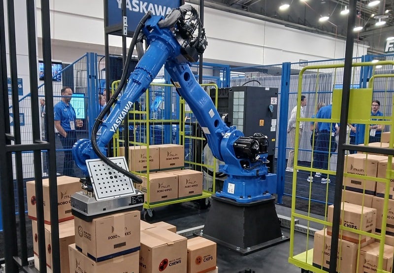

 Figure 3. Partnerships between robot and software companies can help optimize motion paths and decrease cycle time. Image used courtesy of Control.
Figure 3. Partnerships between robot and software companies can help optimize motion paths and decrease cycle time. Image used courtesy of Control.com - Yaskawa at a trade show
AI Computing System
Some palletizing operations do not rely on the robot or an external PLC controller. Instead, all the data acquisition from cameras and scanners is collected in a central computer, and through the help of efficient algorithms (usually AI), motion paths and destination points can be computed in real-time.
The major advantage of this system is that for different products, a different motion path may be more efficient. If the computer can continually compute the quickest path, the cycle time is always kept to a minimum, even with mixed SKU payloads.
