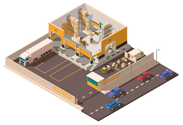

Layout design can greatly impact warehouse efficiency. It concerns the arrangement of product storage within specific areas. An optimal layout design reduces task times and bottlenecks.
Clustering Algorithm
A clustering algorithm, such as K-Means, can analyze product attributes and historical data to determine an efficient arrangement of storage based on attribute similarities and the likelihood of co-ordered items.
3D render of the layout floor plan of a warehouse
Figure 3. AI can help with the spatial planning and optimization of a storage area. Image used courtesy of Adobe Stock

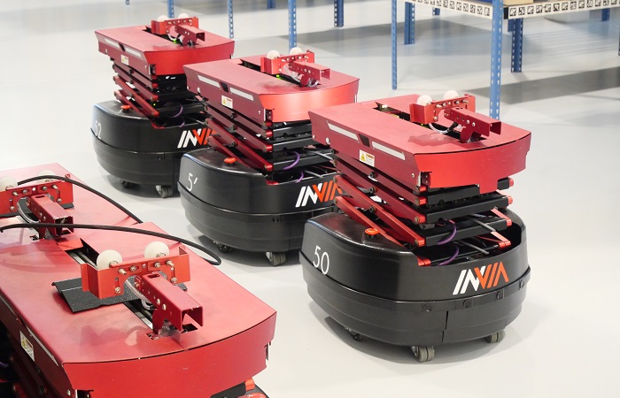

Autonomous mobile robots (AMRs) are often (and increasingly) AI-based, relying on technology instead of manual input to deliver the most optimized results. Many of their functions rely on some of the most advanced algorithms available today.

Navigation and path planning are two of the most important characteristics of any AMR system. Within a warehouse, AMRs need to know where they are with respect to the system of coordinates. They also need to know what the safest and most efficient path ahead is. To do this, AMRs use algorithms like Dijkstra. This algorithm is specially designed to help find the shortest path within a network of roads by considering factors such as maximum speed allowed, path costs and penalties, and temporary traffic situations.
A fleet of AMRs and AGVs at work in a production facility
Figure 4. AMRs are advanced AI-powered material handling machines. Image used courtesy of Control.com
AMRs also leverage computer vision systems for navigation and object recognition. Vision systems enhanced with neural network processing logic help AMRs with object identification. This is how these vehicles can pick up or drop objects safely.
