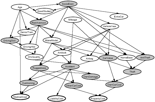

A Bayesian network is an example of a graphical algorithm. It employs what is known as Directed Acyclic Graph (DAG) to represent the probabilistic relationships within a collection of random variables. The network uses these relationships to make inferences on a causal basis. These networks work particularly well when dealing with uncertainty in the data. A portion of this uncertainty is caused by having incomplete data, which is a common scenario in demand forecasting.
An example Bayesian network
Figure 3. A Bayesian network representing factors in the selection of automobile insurance. Image used courtesy of TU Gratz
