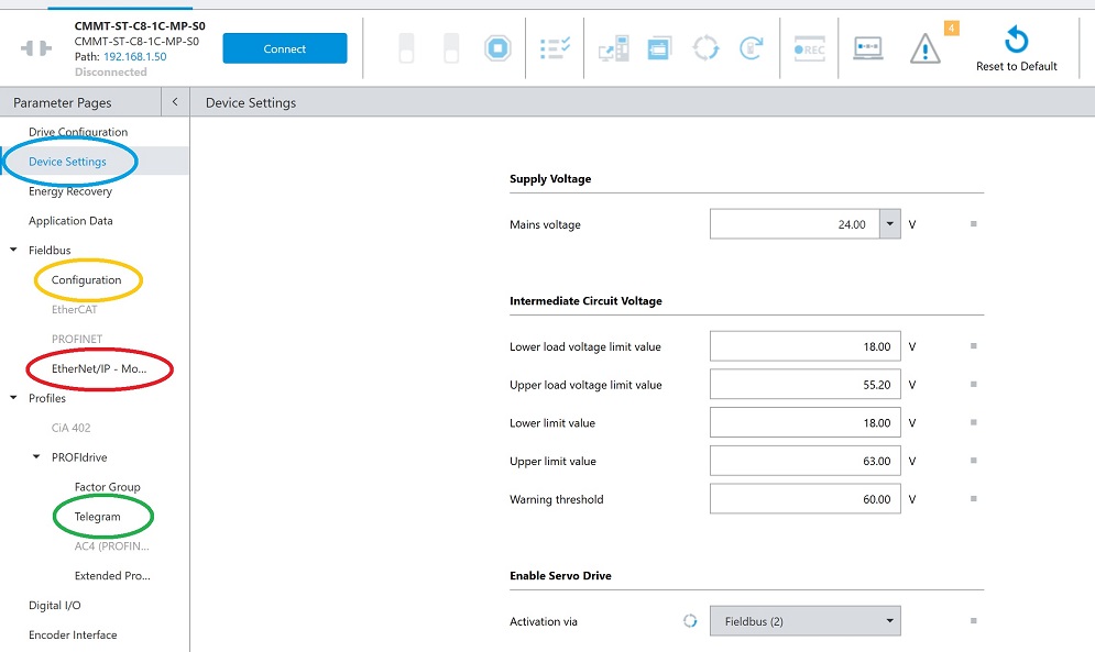

First, we need to switch the drive to allow commands via fieldbus. Open Festo Automation Suite with the previously saved project and double-click on the drive device shown in the window to initialize the plug-in. Go to the “Parameterization” tab and select “Device Settings” (blue oval in Fig. 2 below). At the bottom, beside “Activation via,” select “Fieldbus” from the drop-down.
The “-MP” in the part number indicates this as being a multi-protocol drive; it can be either EtherCAT, PROFINET, or Ethernet/IP. Our example will use a Rockwell PLC, so Ethernet will be our selection. To select Ethernet, expand the fieldbus menu, and select “Configuration” (yellow oval in Fig. 2). “Ethernet/IP - Modbus TCP” will be found in the drop-down menu.
The next step is setting the IP address to the same subnet as your PLC. Select the “Ethernet/IP - Modbus TCP” tab on the left sidebar (red oval in Fig. 2). The fieldbus IP address is set there.
One final step for point-to-point control is to set the telegram structure. This allocates the data packets in the right location so that we can use certain pre-built PLC add-on instructions. Expand profiles, then PROFIdrive, and then select “Telegram” (green oval in Fig. 2). In the Telegram section, choose (111).
 Figure 2. Locations for setting the CMMT to activate via fieldbus.
Save these parameters to the drive and restart. If the PLC isn’t connected to port XF1 IN yet, this is a good time to connect.

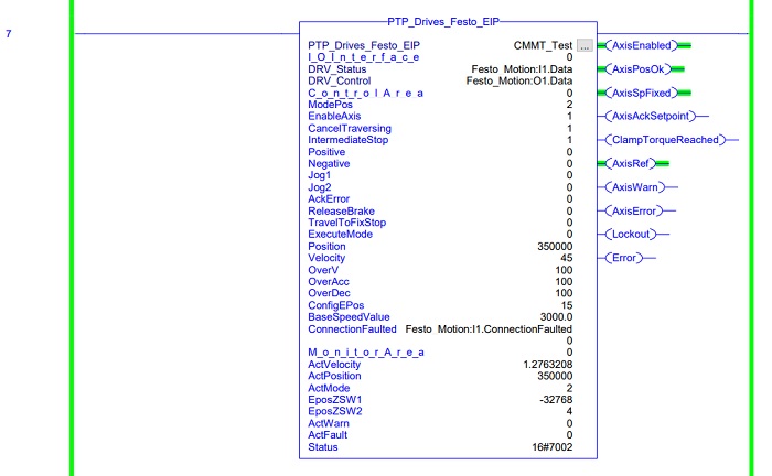

In the main routine, create a new run and drop in one of the new PTP AOI commands. This function block has a long list of status outputs and input parameters to be linked to tags. In the name field at the top, PTP_Drives_Festo_EIP, assign a name for this axis, right-click, and create this as a new tag. It will be placed in the program scope tags folder.
We also need to connect the input, output, and connection areas to the tags that were created when we defined the module. Remember the module name from the previous section? Use that name to assign the following tag areas:
DRV_Status = Module_Name:I1.Data
DRV_Control = Module_Name:O1.Data
ConnectionFaulted = Module_Name:I1.ConnectionFaulted
Download this program to the controller. First, check to make sure the I/O OK is solid and communication with the CMMT. Next, look at the function block on the rung; the Error and Lockout output bits should be off (if they are on, go back and verify that the CMMT is set to activation via fieldbus).
If all is well, first, set the ModePos to 4 (homing mode), the AxisEnable to 1, and the ExecuteMode to 1. This will home the axis and enable positional commands.
Now, change the ModePos back to 2 (for absolute positions; 1 would be incremental moves). Set a Velocity, something moderate like 30-40 mm/s as a test. If the homing procedure completed successfully, look at your axis and assign a Position. This value is scaled to thousandths of mm (μm), so a target position of 150 mm would be 150000 in the tag.
Once the velocity and position are in place, toggle the ExecuteMode bit to 0, then 1 for a rising edge trigger. Explore various velocities and positions, and re-execute to run the program.
 Figure 5. The add-on instruction for point-to-point commands.
