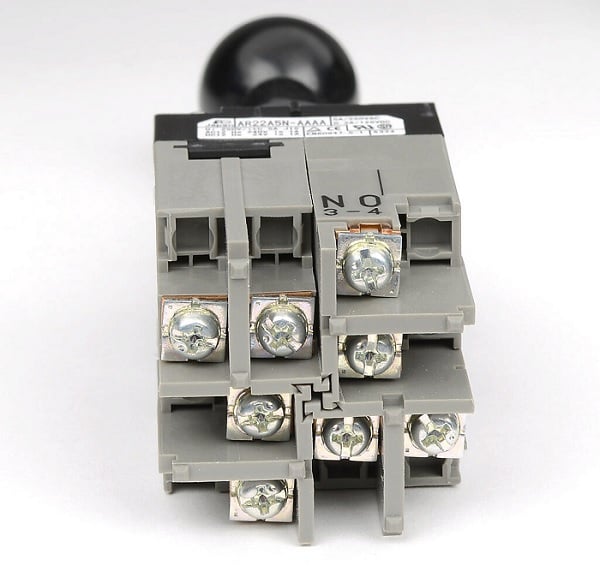

 Figure 2. Digital joysticks typically come with N/O or N/C switches already included (AR22A0N-A0A0B).
Figure 2. Digital joysticks typically come with N/O or N/C switches already included (AR22A0N-A0A0B). Image used courtesy of AutomationDirect

Digital Joystick Wiring
Overall, digital joysticks are essentially pushbuttons and are therefore wired very similarly, as shown in the figure above. In a 1-axis system, the joystick will have four contact terminals, a pair to indicate +x and a pair for -x. In a 2-axis system, the joystick will have eight terminals, since another four are added for +/-y. If the user pushes the joystick forward, the contact in that position will close, allowing the object to move in the set direction at the set speed.
 Figure 3. When wiring a digital joystick, it's as easy as wiring a normal switch. This one includes 4x sets of normally open contacts.
Figure 3. When wiring a digital joystick, it's as easy as wiring a normal switch. This one includes 4x sets of normally open contacts. Image used courtesy of AutomationDirect

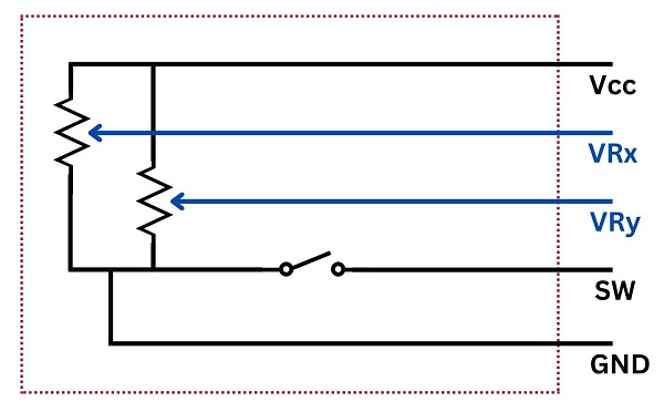

Analog Joystick Wiring
As for the wiring of an analog joystick, it is very simple. The contacts will include a pin for GND and a VCC pin for the supply voltage (typically 5 V for microcontroller integration, or 10 V for industrial use). There is likely also a switch pin which is an optional output for a pushbutton that’s on top of some joysticks. This switch pin is meant for a digital input module, but it must be provided with 24 V for most PLCs.
 Figure 5. Contacts for a typical analog joystick with an optional pushbutton control (usually at the top of the joystick).
Finally, and perhaps most importantly, you will find variable outputs for the X and Y (perhaps labeled VRx and VRy), and possibly more depending on the number of axes controlled. These two variable signals will be attached to analog inputs in the PLC.
In the above example image, we see a two-axis system: x and y. The VRx and VRy contacts generate a voltage that is proportional to the position of the joystick when it is moved. So let’s say for a 10 V system, if you let go of the joystick, VRx should read 5 V. As the joystick is jogged to the left or right, VRx will read between 0-5 V or between 5-10 V, proportional to its position from the center point.
Note: Due to the wiring setup of this switch in the image, our digital input module must be of a 'sourcing' variety. A Vcc of 10 volts will be suitable for the analog input voltage, and 24 volts supplied by the digital module will both be compatible at the same time. If the switch is attached to the Vcc pin, then a sinking input module may be used, but you cannot provide both 24 volts for the switch and 10 volts for the potentiometer.
This is a somewhat rare case that proves the usefulness of a sourcing input module!
