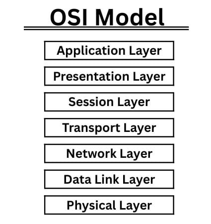

The IT/OT protocols work at different layers of the OSI (Open System Interconnection) and TCP/IP models. The OSI framework and TCP/IP model split the network into distinct layers, and each layer has its own functionality. The conceptual understanding of the aforementioned models/guidelines is helpful for engineers to design the network data flow securely and make troubleshooting easy. The OSI is the conceptual framework that divides communication into 7 layers, while TCP/IP is a 4-layer model. As shown in Figures 1 and 2, the OSI and TCP/IP models are given below.
 Figure 1. Communication layers of the OSI (Open Systems Interconnection) reference model.
Figure 1. Communication layers of the OSI (Open Systems Interconnection) reference model. Image used courtesy of the author

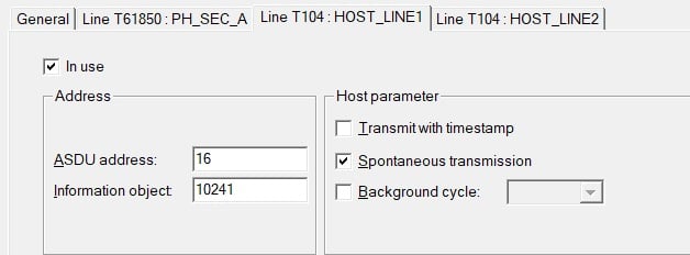

The IEC-104 is a well-known and widely used communication protocol in the power generation, transmission, and distribution control system for telemetry data exchange (status, measurand, and command). The protocol is designed to run over TCP/IP, having a standard default port#2404. It's a client/server model where the centralised control system acts as a client and remote field devices act like a server, reporting data to the client.
MFI: Analog Measurement Value Float Type.
ASDU: Application Service Data Unit contains data type, number of data objects, address for data objects, etc.
IOA: Information Object Address: The telemetry point in this case is the “Feeder 1” Current, which is the telemetry point by the information Object (10241) with the ASDU data unit.
 Figure 3. Configuring the IOA and ASDU address (IEC-104) for the Feeder-1 current.
Figure 3. Configuring the IOA and ASDU address (IEC-104) for the Feeder-1 current. Image used courtesy of the author

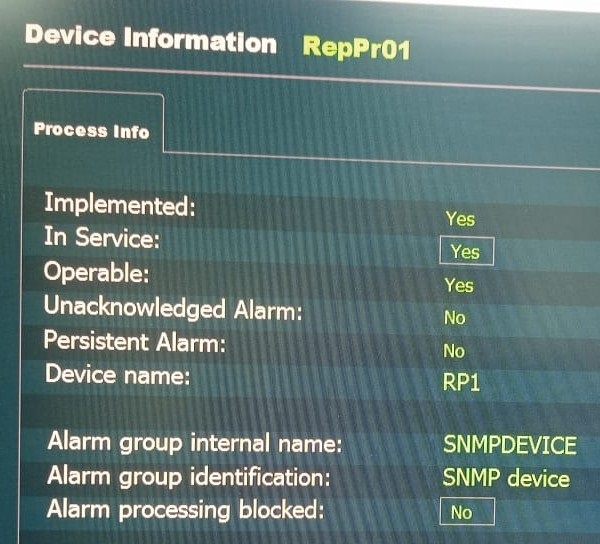

SNMP is a protocol for monitoring devices in the network, which helps to detect and resolve problems quickly in the whole network. Initially, the SNMP was developed for monitoring of the router and switches, and now it has been extended for a wide variety of devices, like power supplies, etc.
 Figure 4. Monitor and report the network printer status on the operator HMI using the SNMP protocols.
Figure 4. Monitor and report the network printer status on the operator HMI using the SNMP protocols. Image used courtesy of the author
The aforementioned OT related protocols are used to monitor and control the process data, and the telemetry data must pass through the secure communication link between field devices, switches, firewalls, and servers. Therefore, the health of the network infrastructure is also very crucial for plant operations, and monitoring can be done using the SNMP (Simple Network Management Protocol).

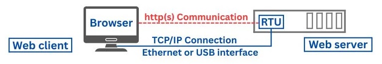

The common term “HTTP” stands for Hypertext Transfer Protocol, and HTTPS is the secure version of HTTP, where the data is encrypted as it is sent between the web browser and the web server.
 Figure 5. Web client and web server secure communication over TCP/IP connection.
Figure 5. Web client and web server secure communication over TCP/IP connection. Image used courtesy of the author
In Figure 5, the common industrial application is to access the integrated web server of the RTU via TCP/IP connection. On the web client side, different common browsers are used to connect with the web server. As per Figure 5, we can easily configure, troubleshoot, upload/download firmware and configuration files, information of I/O modules information and log in/log off to the RTU using the secure TCP/IP connection from a laptop/desktop.

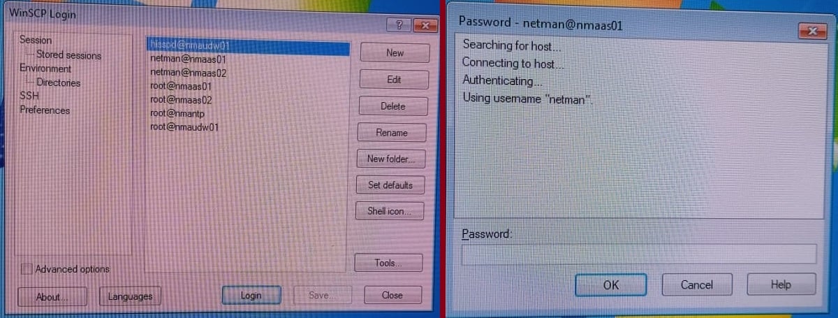

FTP/SFTP is another file transfer protocol widely used to transfer settings in the heterogeneous network of IT/OT nodes. The SFTP is used to transfer information and files with encryption over the network to the nodes. In a plant, the maintenance engineer can back up the new configurations and download the updated firmware to the IT/OT devices over SFTP/FTP and reboot the targeted device to apply the changes.
In the servers and workstations, we can copy project files on multiple nodes, backup and restore the PLC program, relay settings, and copy the router/switches/firewall configuration in text format for later use. Another use case is to copy the relay settings to the IEC 61850 IEDs file, like IED Capability Description, and CID (Configured IED Description).
 Figure 6. WincSCP file transfer Windows-based application, connecting to a remote server, asking for username/password.
Figure 6. WinSCP file transfer Windows-based application, connecting to a remote server, asking for username/password. Image used courtesy of the author
The most popular user-friendly WinSCP application is an explorer-like tool for transferring files over FTP/SFTP from a local computer to a remote server in a secure manner. The application asks for the credentials(username/password) of the remote server to connect before transferring the files.
