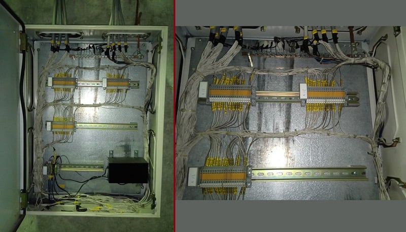

The traditional 4-20 mA loop current is widely used in the industrial control system for process control. It is also called a live zero, because the 4 mA minimum signal corresponds to a 0 (or minimum) of the actual process value, like current, voltage, flow, speed, etc. The maximum signal is 20 mA, representing the maximum process value range. The live zero standard helps maintenance field engineers troubleshoot open-circuit faults quite easily, such as a broken wire, when the signal actually drops to 0 mA.
The other common signal type, 0-10 V DC, is acceptable for many applications, but according to Ohm's law, in a series circuit, the voltage drop increases across long-distance wires, thus causing signal loss. If the transmitter is located near the process, but far away from the controller or RTU, the mA signal works best. It is a good option for long-distance applications compared to the voltage signal.
In Ohm’s law, V (the voltage drop) equals the product of I and R. In the signalling circuit, the voltage drop equals the current multiplied by the resistance of the wire. The resistance (R) in the circuit increases as the wire grows in length. A local transmission from one panel to another nearby I/O panel, or an analog sensor connected to a nearby controller; these are both good applications for a voltage signal.
In recent times, many microcontrollers and digital I/O boards require a 1-5 volt DC signal, but a 4-20 mA signal is preferred in the industry. For ADCs in RTU/PLC/controllers, a 250 Ω resistor is installed on the receiver end or the connection unit to convert a 4-20 mA signal into a 1-5 volt signal.
 Figure 1. Conventional 4-20 mA current loop wiring in the terminal box.
Figure 1. Conventional 4-20 mA current loop wiring in the terminal box. Image used courtesy of the author

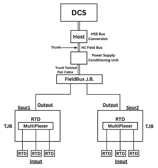

It is witnessed in legacy 4-20 mA devices that separate cables must be routed to the control room or the RTU/PLC marshaling panel for each device. Fieldbus devices can all be connected to the network in a bus or star topology, and a single cable routes from the junction box to the control room to the controller device.
As per Figure 2 below, multiplexers are installed in the junction box. The role of a multiplexer is to convert several input wires into a single, selectable output wire, called a spur. The spur is a wire on which the power supply and communication signal are supplied. In practice, multiple multiplexers are installed in a junction box. The multiplexer could be an 8-channel to accommodate several RTDs.
 Figure 2. Fieldbus topology consists of a spur and a trunk.
Figure 2. Fieldbus topology consists of a spur and a trunk. Image used courtesy of the author
While discussing the fieldbus protocol, there are some well-known terms like trunk, spur, terminator, H1 bus, and HSE bus, which are the fundamental parts of the foundation fieldbus implementation.
Trunk: The main communication bus, acting as a source for other spurs.
Spur: The branch cable used to connect the field devices to the main trunk.
H1 Bus: Also called the fieldbus, the purpose of the H1 bus is to connect field instruments (RTDs, sensors). For both power and communication, 2-wire twisted-pair cable is normally used.
HSE Main Plant Network: Higher-speed Ethernet for plant-wide communication
