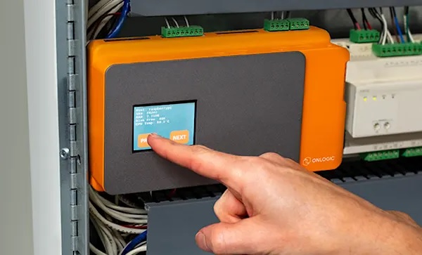

 Figure 3. An industrial Raspberry Pi, likely being used as an edge server.
Figure 3. An industrial Raspberry Pi, likely being used as an edge server. Image used courtesy of OnLogic
Living On The Edge
The IIoT and Industry 4.0 movement is mostly about devices communicating with IT equipment. This will often require an edge device that runs applications and can communicate with OT devices and IT devices. An edge server will typically live in the control panel and be connected to both the machine network and the plant network. The server can then collect data from the machine then push the required data up to the IT servers for further analysis. Node.js has the capability of communicating with these devices, but you will need to have some level of programming experience to develop an application, or you can use Node-RED.
Using Microcomputers As Edge Servers
The Raspberry Pi is a single-board microcomputer. It runs a version of Linux and has become very popular with DIY and hobby electronics enthusiasts. The Pi has become so popular that there are even industrial versions with DIN mounting features and industrial cases, like the Factor series IPC from OnLogic.
With Node-RED being JavaScript-based, it easily installs on a Raspberry Pi. Once installed and the Raspberry Pi library is configured, the Node-RED interface is capable of reading and writing to the board's inputs and outputs on the 40-pin GPIO. In virtually seconds, you can have an application that can read inputs, set outputs, and have a user interface, all running on a computer the size of a credit card.

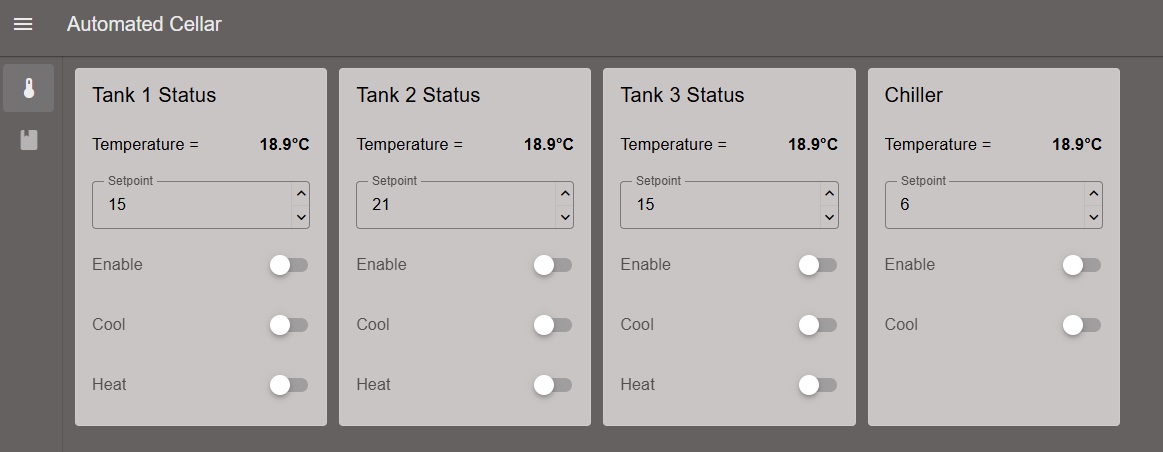

 Figure 5. A Node-RED dashboard for an automated cellar with heating, cooling, and setpoints.
Figure 5. A Node-RED dashboard for an automated cellar with heating, cooling, and setpoints. Image used courtesy of the author
Node-RED Applications
With the intuitive interface, supported communication protocols, and the community forum, the possibilities of different applications are almost endless. The Node-RED documentation pushes the IIoT applications, such as HMIs, edge servers, and data acquisition systems. With devices like Opto 22’s Groov RIO PLC or Bosch Rexroth’s ctrlX Core IPC supporting Node-RED natively, you could build an entire automated machine using Node-RED for both your control logic and HMI.
