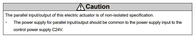

However, the tradeoff is that the designer must ensure that the signal is coming from a source that shares the same input power supply as the motor drive. This fact is also noted in the manufacturer's docs:
 Figure 2. Manufacturer’s note that I/O power supply and controller power supply should be common.
Figure 2. Manufacturer’s note that I/O power supply and controller power supply should be common. Image from SMC product datasheet

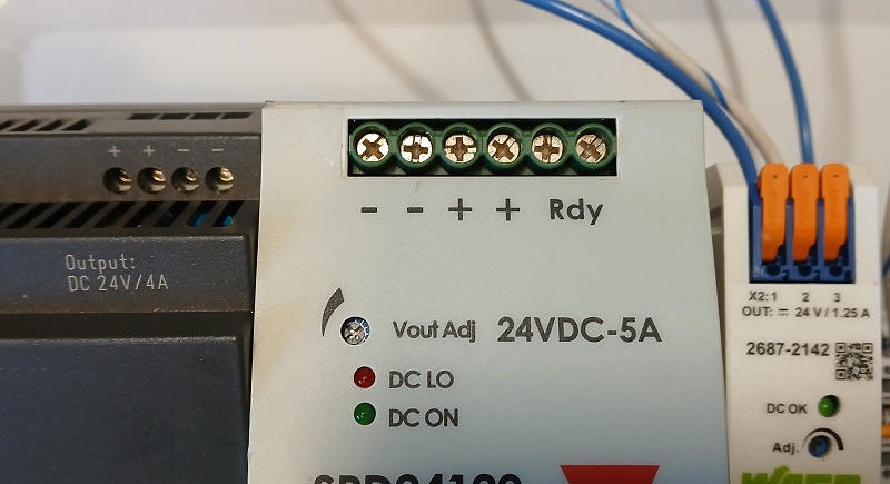

Most Simple: Connect the Common Grounds
In most situations, there will be at least one open terminal block in the control cabinet that is connected to the (-) of the power supply. Even if not, a new one can be placed beside an existing block and jumpered to provide the common connection.
Many power supplies even include an additional (-) that can be used to parallel the power supplies.
 Figure 3. Many power supplies contain 2 or even 3 (-) terminals to link multiple systems.
Figure 3. Many power supplies contain 2x or even 3x (-) terminals to link multiple systems. Image used courtesy of the author
Using this terminal block or (-) on the power supply, a single wire can be spanned to connect the (-) of the drive supply to the (-) of the PLC field I/O supply.

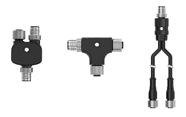

The power connection to the device is usually a type of M12 connector, which is an industry standard. The point at which the M12 cable plugs into the socket of the drive might be a great place to secure the common connection. An M12 splitter, like a Y, T, or pigtail style, can allow the user to access a (-) connection without disrupting the wiring inside the control cabinet.
 Figure 4. Many options exist for splitting M12 cables: (L-R) Y-splitter, T-splitter, and pigtail splitter.
Figure 4. Many options exist for splitting M12 cables: (L-R) Y-splitter, T-splitter, and pigtail splitter. Image (modified) used courtesy of Banner Engineering
It is highly inadvisable to locate a (-) wire, cut it, and insert a splice connector. These can damage the cables and will create confusion by adding unlabeled wires into the cabinet. M12 splitters are secured with threaded connections for security, and the wires can be clearly labeled.

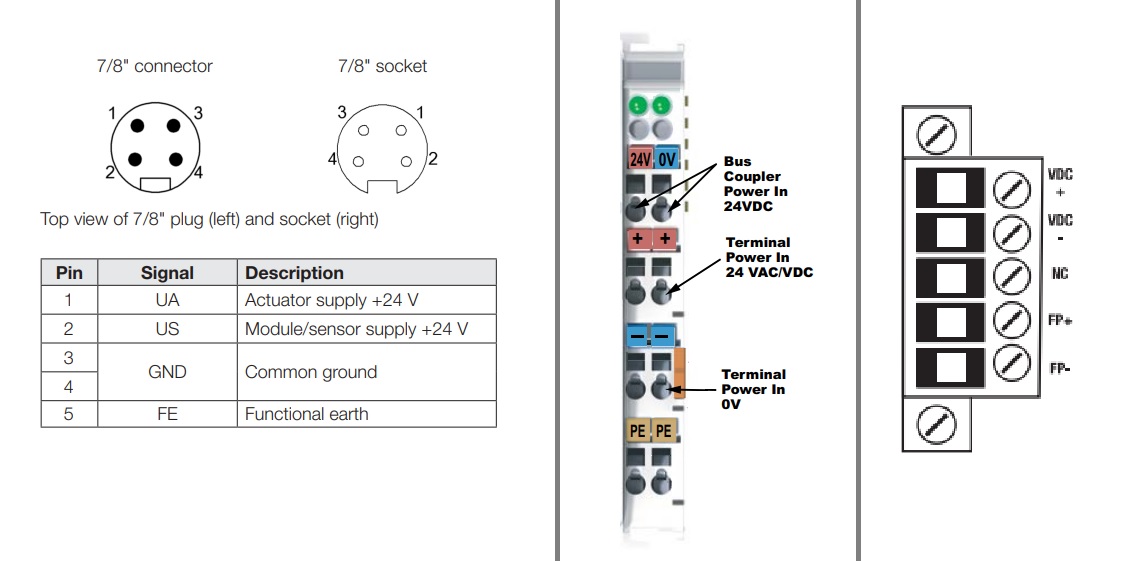

Many I/O devices now run on branching networks between nodes and controllers. A couple of great examples are IO-Link and Modbus, both of which offer plentiful examples of remote I/O hubs. When the wiring datasheets of these are examined, there is a difference between the power input for the processor and the power provided to the terminals (field power supply). Some PLCs even include isolated terminals for module vs. field device power. When faced with both of these, do they BOTH need to connect to the common (-)?
 Figure 5. A few examples of devices with separate supplies for powering the module vs powering the field device terminals: (L-R) IO-Link master from Balluff, remote I/O from AutomationDirect, PLC from Rockwell.
The answer is no; only the field power supply will provide the voltage for digital signals at the I/O terminals. Therefore, only the field power supply must share a common (-) between the module and the remote drive that receives the signals.
To explain further, the supply that powers the CPU or the network is irrelevant. None of that power is transferred to the I/O terminals. Only the field power supply must share the common connection.
