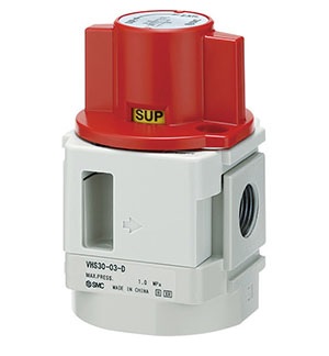

The Shut-Off And Regulator
At a bare minimum, equipment that lives downstream of an air compressor must be protected with a shut-off valve and a regulator. These components allow for the system to be de-energized of incoming stored energy, (compressed air) and to control the amount of pressure being fed into the system.
A shut-off valve is a fairly obvious on/off switch, often including a feature to allow operators to attach a lock and tag for safety purposes. When locked out, the valve will not be able to actuate back into the open position.
The primary function of the valve is to remove the connection to the air supply when the valve is shut off. In some cases, a valve is outfitted with a pressure relief function to bleed the residual air out of the system. If this is not included, an external pressure relief must be used downstream of the shut-off valve.
 Figure 2. Shut-off valve with a lock-out and pressure relief features.
Figure 2. Shut-off valve with a lock-out and pressure relief features. Image used courtesy of SMC
The regulator is a device that controls the amount of air pressure entering the system. The air pressure inside the compressor tank is often much higher to accommodate pressure drops from long runs of pipes and tubes. All devices within a system have a maximum pressure rating; if the pressure exceeds the maximum, the device could be damaged.
These two devices will often be connected together. Maintaining these devices is simply actuating them once a month to make sure they are still functional.
