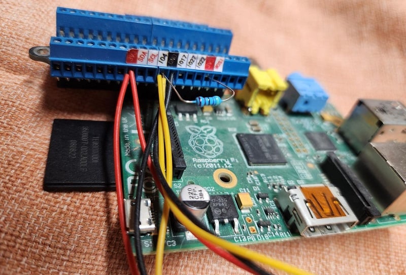

 Figure 2. Image of the Raspberry Pi wired with temperature sensors.
Figure 2. Image of the Raspberry Pi wired with temperature sensors. Image used courtesy of the author

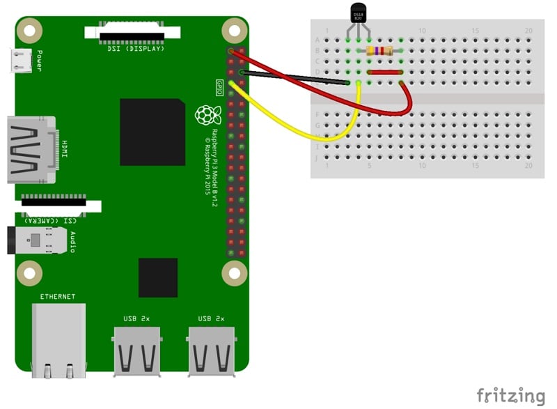

Wiring The Sensor
The wiring is simple but will require a 4.7kohm resistor. Vcc and Gnd are wired to 5VDC and ground, respectively, with the SIG wire going to an empty input on one of the GPIO pins. The resistor will be connected to power and the signal wire. Each sensor will be connected the same way, and to the same input.
 Figure 3. Wiring example of a DS18B20 temperature sensor.
Figure 3. Wiring example of a DS18B20 temperature sensor. Image used courtesy of Wikipedia

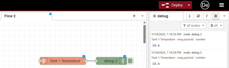

I like to start with the inputs when programming, so I’ll add my ds18B20 node to the flow. The properties of the node will allow you to select which sensor you want to read. If there are no sensors listed, ensure your wiring is correct before continuing. You will also need to set a periodic rate; otherwise, the node could reduce your Pi’s performance with excessive processing. Drag and drop a debug node onto your flow and wire it to the sensor node. This will allow you to see the temperature live in your debug window.
 Figure 5. Reading the temperature from the sensor into the Raspberry Pi.
Figure 5. Reading the temperature from the sensor into the Raspberry Pi. Image used courtesy of the author

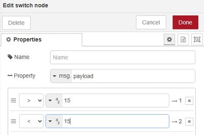

Now that we are reading the temperature, we can apply some logic. Using the switch node, we can create an if statement that will output the payload if our temperature is greater than some value. Again, use the debug node to test if the switch node is working as expected. To ensure we turn off the output when the switch statement is not true, we will need to add a rule and check for less than the set value.
 Figure 6. Switch node properties to output a payload if the temperature is greater than or less than a value.
Figure 6. Switch node properties to output a payload if the temperature is greater than or less than a value. Image used courtesy of the author

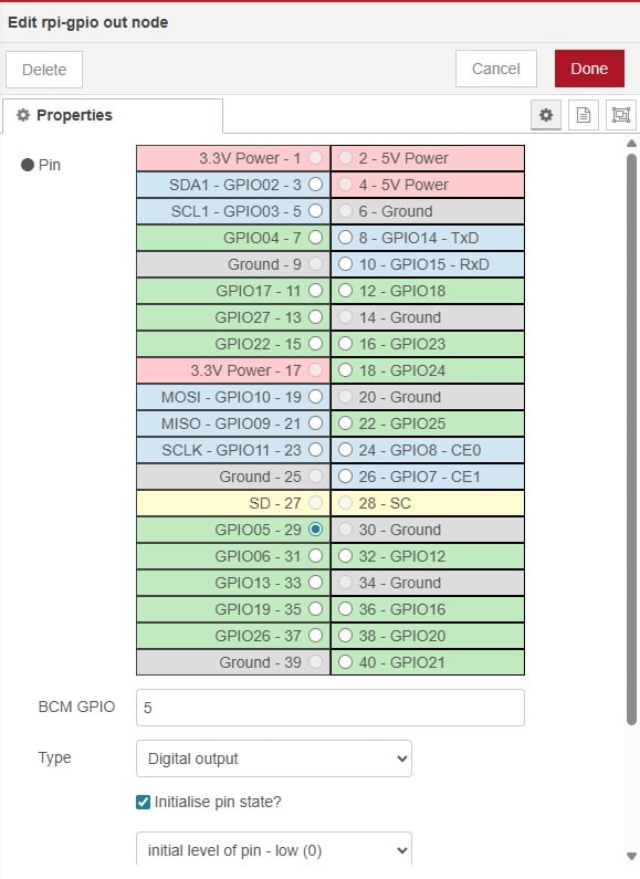

The GPIO out node requires a payload of either 0 or 1, so we need to change the payload depending on whether the switch node results in greater than or less than. We use two change nodes to set the value of the payload to either 1 or 0, and wire them to the two outputs of the switch node.
 Figure 7. Setting the GPIO output properties.
Figure 7. Setting the GPIO output properties. Image used courtesy of the author
Now we are ready to send the output to our GPIO pin using the Raspberry Pi output node. We simply drag and drop the output node onto the flow and connect both change nodes to the one output node. The properties allow us to select the pin we want to use for our output.

Now, when the temperature is above the value we used in the switch node, the upper change node will set the payload to 1, and the output node will set pin 29 to output 5VDC. When the temperature drops below the switch value, the lower change node will set the payload to 0, resulting in setting pin 29 to low, or no voltage.
