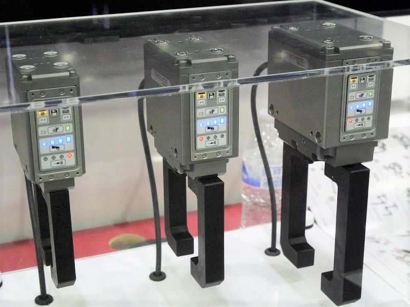

End of Arm Tooling for Cobots
Cobots, being designed for safety, will have maximum payloads far lighter than their industrial relatives. The design of grippers must be factored into that payload, and this leads to greater innovation on the part of lighter, stronger materials. Since cobots can be more easily moved from place to place in a facility, there are also some special concerns about connecting them to prohibitive energy sources, such as pneumatic lines which may not be located at all spots. The design of tooling is certainly one of the major challenges in the world of industrial and collaborative robotics.
