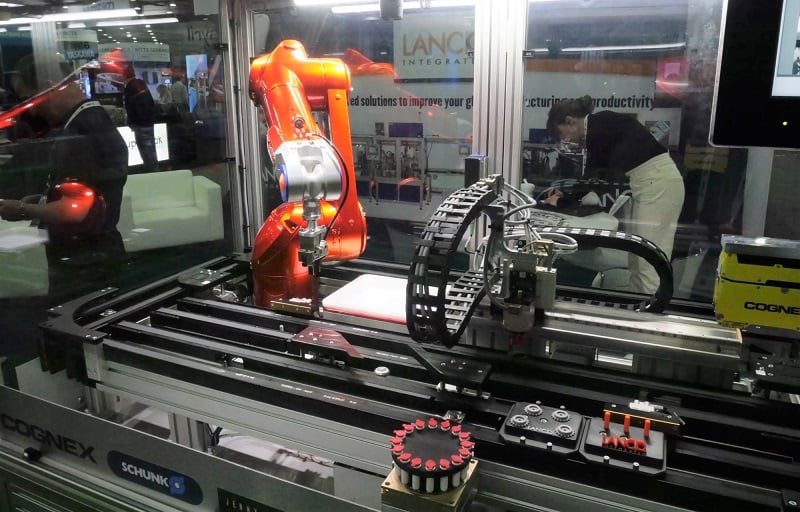

Regardless of the problem type presented here, the isolation of robots from people is absolutely the most guaranteed form of safety. This means that the normal solution is a metal gridded cage around the robot with a single door, latched and monitored by magnetic coded interlock sensors. If any opening exists where a person may reach into the cage alongside conveyed products, an additional optical barrier (light curtain) ensures safety at all times.
