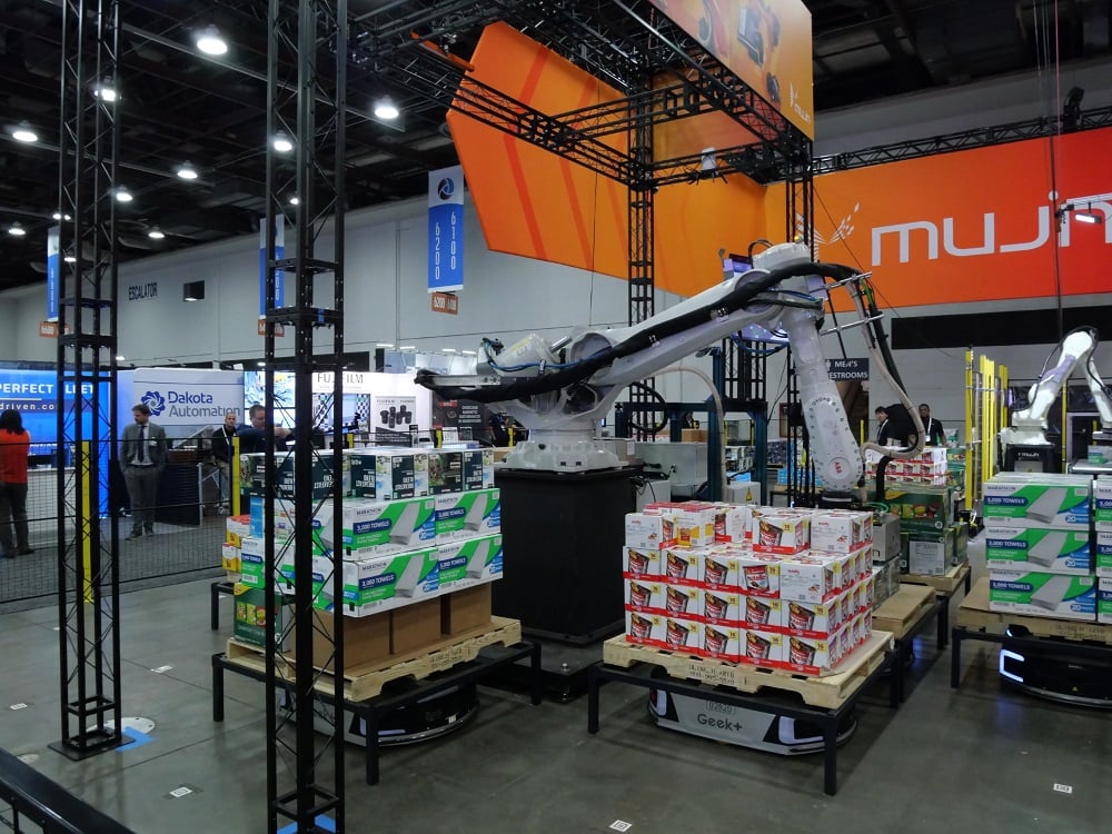

Articulated Arm, or 6 Axis Robot Arm
These are the devices that will most often be referenced by the number of rotating joins, commonly between 4 and 6-axes. Fewer axes results in greater payload capacities, but decreased range of tool motion.
A 4-axis industrial robot arm is unable to swivel the gripper to all positions, and is ideally suited for moving payloads that are always alighted with the ground, or the horizontal plane. The base of the robot on this horizontal plane is identified by the X-Y plane, so the payloads on these 4-axis robots are able to move linearly along the Z-axis, but not rotate around it.
We often find these robots loading and unloading pallets, since the infeed and outfeed conveyors, and the pallet, are all arranged around the robot, but level with the ground. The reduction in axes results in easier jogging/teaching procedures, decreased ongoing maintenance and failure points, and lower power consumption.
For more complex manipulative tasks, such as welding and painting, where hand control around corners and over angled surfaces is required, the 4-axis robot simply is not sufficient. A 5th or 6th axis allows freedom of motion for the end tool nearly anywhere within the work envelope of the robot.

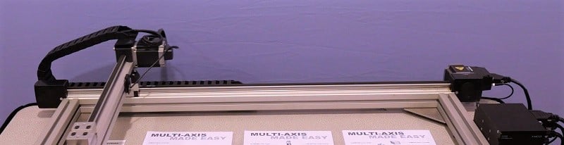

Cartesian (Also Gantry or Linear) Robots
Both of the previously presented robots contain rotational axes, but these are limited in the maximum reach of the tool. If a long span of motion is required, the often-used model is a combination of long linear beams that serve as guides for straight-line motion.
These types of robots might sometimes go by other names, like a CNC table used for lasers, waterjet, or plasma cutting, so we might not immediately recognize these as a robot. Regardless of the name, these combinations of axes move a tool to accomplish a task and are, therefore, robots indeed.
Three main modes of power transfer are used for these long, linear axes.
First is the toothed rubber timing belt. A motorized sprocket at one end of the axis turns the belt, and with the proper tension, moves a carriage along the beam. For stability, the carriage is attached with rollers that glide along grooved beams of metal. Larger carriages will contains more durable, solid bearings.
For long spans, the belt must be properly tensioned with springs or idler pulleys, and will usually be much thicker for durability. For shorter spans, the belt is pulled to hand-tight then secured with a small screw-down plate. Unless subjected to abnormal force, it will not need any further adjustment.
The second common power transfer mode is the ball or lead screw. A threaded shaft, much like any normal screw, is rotated by a motor. The carriage mechanism, which resembles a threaded nut, is moved axially along the shaft as the motor rotates. This method is excellent for control, and, much like a worm gear, is nearly immune to backlash. With a minor reverse force applied to the payload, the ball screws will prevent it from easily driving back against the motor.
Long spans can be difficult for ball screws. The weight of the metal shaft will cause it to sag, and as the motor spins, harmonics can develop along the length, causing vibration and damage to the carriage and its bearings. This method is very common for short CNC machine axes, but less common for spans longer than just a few feet or meters.
The final power transmission for long linear axes is a rack-and-pinion gear method. The moving carriage is outfitted with a single motorized spur or helix gear, meshed to a single long row of matching teeth along the entire length of the axis. An advantage to this method is that the axis can be infinitely long with no additional sag, stretch, or droop that are introduced with the other methods.
Gears can also provide more control over travel speed. Changing the driving pinion gear size, or attaching the motor to a gear train which is ultimately driving the pinion can multiply the precision of each step of the motor. In so doing, it might decrease the speed of rapid transverse, but gears are exceptional methods of creating precise motion in ways that timing belts and ball screws cannot.
Cartesian Work Envelope
These systems are called by the name cartesian because they naturally move only in an x, y, and z direction. The articulated arms are circular, so x-y-z coordinates must be calculated trigonometrically. Since humans measure distances linearly, the cartesian axes are easy to manipulate. Moving multiple axes at a time can recreate angles, arcs, and circles. Since they are designed with three linear axes, the work envelope for these robots is a rectangular prism.

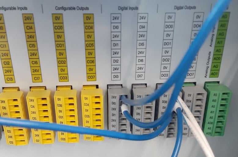

Robot I/O Commands
Even the most simple robots are designed to complete a task. The attachment placed onto the end of the arm, the tool, must be activated periodically to complete the task. This is accomplished by some form of input and output signal.
There are usually other I/O points to connect to valves, relays, sensors, and external PLC I/O modules. In many modern cases, an advanced communication protocol like Ethernet, PROFINET, or an IO-Link connection could be used to transfer data between the robot controller and external equipment. These protocol channels are also set up as I/O registers to hold numeric or string text values to use in the code.
To activate outputs, the commands are often very simple, using a SET or RESET for boolean output addresses or by an assignment command (in the form of “variable_name = value;”). For discrete I/O terminals, the only possible values are HIGH and LOW, but for analog I/O or for registers from a communication channel, the values might relate to the size of a box, or a recipe value for a specific product batch, etc.
Using input values is a bit more complex, since they might be used to either drive a decision in the operation of the robot, or they might indicate a value used to determine a motion path. Most input usage methods can take two forms.
  • IF statements are logical decisions based on the value of a register or an I/O. We might say ‘if the gripper is open, close it’, which would be a valid IF statement. We might receive the value of a product barcode, and IF the value fits a certain format, the box is placed on a certain outfeed conveyor. If many choices exist, the IF statement may take the form of a SWITCH/SELECT case, depending on the language.
  • Assigning register values is a method of reading the input, maybe analog or from Ethernet, and placing the value into a storage register for use later in the program after the input value changes. These commands may take the form of ‘register_number = analog_input_address_1’
Most robots are equipped with three main I/O blocks - the local I/O screw terminals right inside the case of the controller (an example of which is shown in the image below with digital and analog terminals), network I/O located on removable, modular network interface cards, or hand I/O located somewhere on the arm itself near the attachment point of the gripper or tool. The commands are the same, but the addresses may be different for each location.
