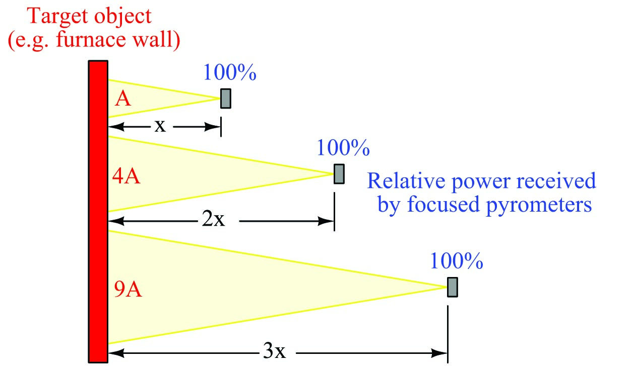

If non-contact pyrometers really were “looking” at a point-source of infrared radiation, their signals would indeed decrease with distance. The saving grace here is that non-contact pyrometers are focused-optic devices, with a definite field of view, and that field of view should always be completely filled by the target object (assumed to be at a uniform temperature). As distance between the pyrometer and the target object changes, the cone-shaped field of view covers a surface area on that object proportional to the square of the distance Backing the pyrometer away to twice the distance increases the viewing area on the target object by a factor of four; backing away to three times the distance increases the viewing area nine times:
non-contact pyrometers at a point-source of infrared radiation
So, even though the inverse square law correctly declares that radiation emanating from the hot wall (which may be thought of as a collection of point-sources) decreases in intensity with the square of the distance, this attenuation is perfectly balanced by an increased viewing area of the pyrometer. Doubling the separation distance does result in the flux from any given point on the wall spreading out by a factor of four, but the pyrometer now sees four times as many similar points on the wall as it did previously. So long as all the points within the field of view are uniform in temperature, the result is a perfect cancellation with the pyrometer providing the exact same temperature measurement at any distance from the target.

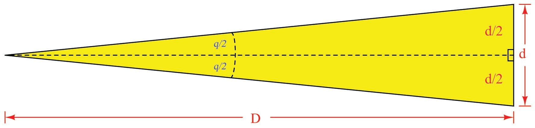

A trigonometric explanation for these equations is shown in the following diagram, where the isosceles field-of-vision triangle is split into two “right” triangles, each one having an adjacent side length of \(D\) and an opposite side length of \(d/2\) for angle \(\theta/2\):
isosceles field-of-vision triangle is split into two right triangles
Since we know the tangent function is the ratio of opposite to adjacent side lengths for a right triangle, this means the tangent of the half-angle (\(\theta/2\)) will be equal to the ratio of the opposite side length (\(d/2\)) to the adjacent side length (\(D\)):
\[\tan \left( {\theta \over 2} \right) = {{d/2} \over D} = {d \over 2D}\]
Solving for the length ratio \(D/d\) is now just a matter of algebraically manipulating this equation:
\[\tan \left( {\theta \over 2} \right) = {d \over 2D}\]
\[{2D \over d} = {1 \over {\tan \left( {\theta \over 2} \right)}}\]
\[{D \over d} = {1 \over {2 \tan \left( {\theta \over 2} \right)}}\]
Solving for the viewing angle (\(\theta\)) requires another form of manipulation on the basic tangent equation, where we “un-do” the tangent function by using the inverse tangent (or “arctangent”) function:
\[\tan^{-1} \left[\tan \left( {\theta \over 2} \right) \right] = \tan^{-1} \left({d \over 2D}\right)\]
\[{\theta \over 2} = \tan^{-1} \left({d \over 2D}\right)\]
\[\theta = 2 \tan^{-1} \left({d \over 2D}\right)\]

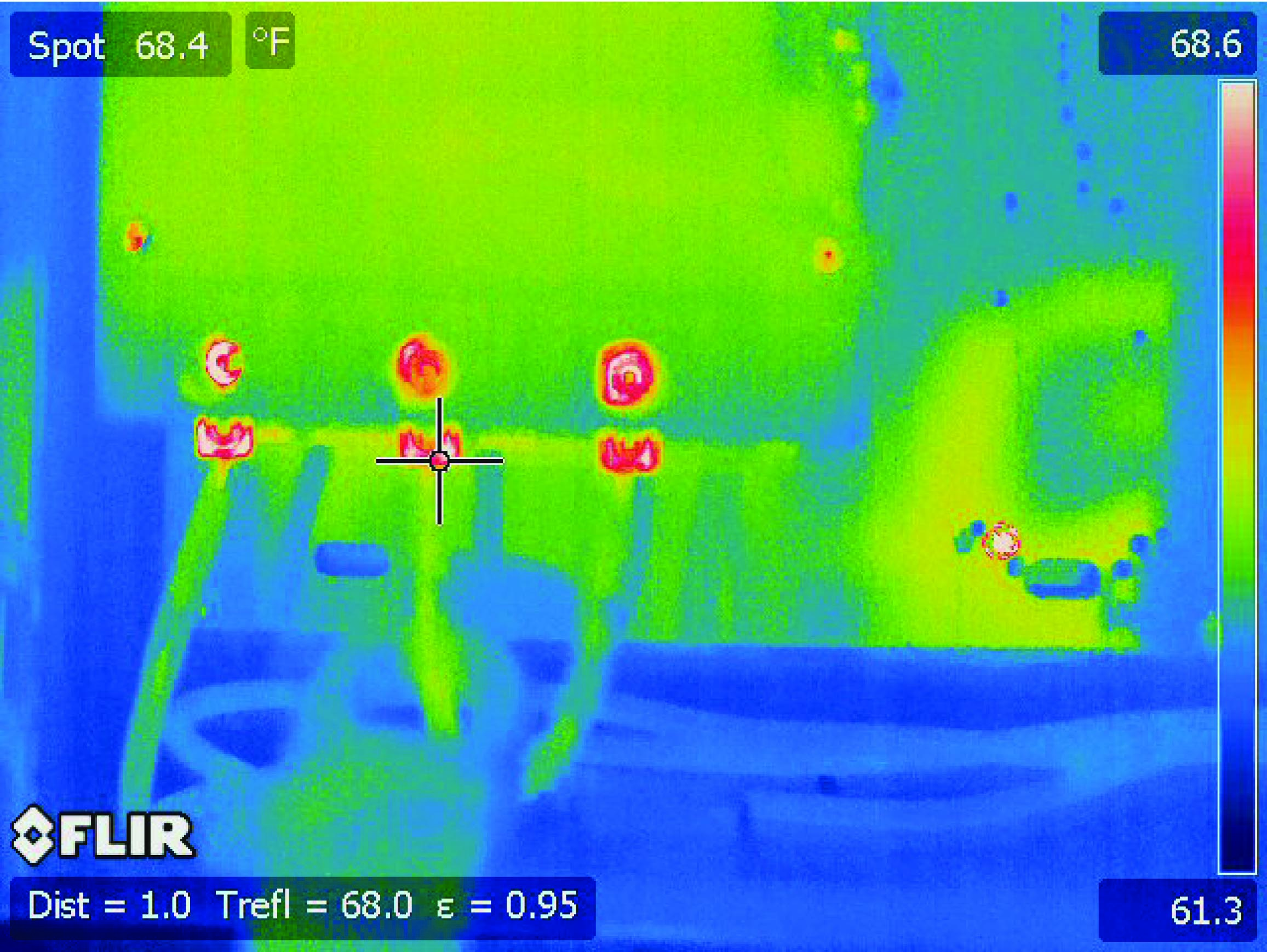

A thermal image of a three-phase circuit breaker shows a much more even distribution of temperature:
a thermal image of a three-phase circuit breaker
The hottest objects in this image are the three load screw terminals, appearing as white/red against a blue/green background. Note the range of the temperature scale on the right of the image: this particular image only spans a temperature range of 61.3 \(^{o}\)F to 68.6 \(^{o}\)F. This narrow temperature range tells us the differences in temperature shown by colors in this image are nothing to worry about.
Here, the instrument provides a single-point temperature measurement of 68.4 \(^{o}\)F at the cursor (“Spot”) location rather than a differential temperature measurement between two points.
