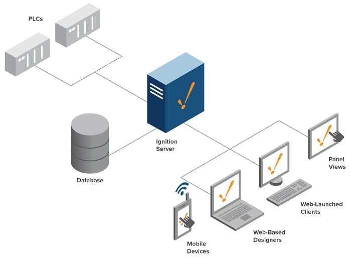

 Figure 1. SCADA controls the flow of information between all components of the automation system.
Figure 1. SCADA controls the flow of information between all components of the automation system. At the heart of this SCADA system is the Ignition Server by Inductive Automation
