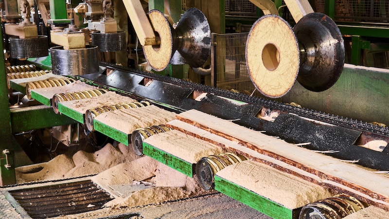

Wood processing is one example of an industrial setting with
combustible dust.
Wood processing is one example of an industrial setting with combustible dust. Image used courtesy of Adobe Stock

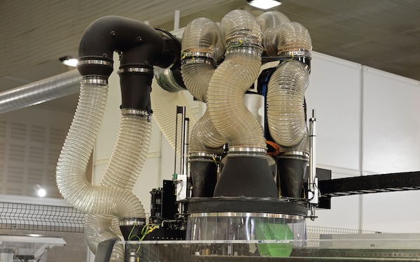

Dust collection alone is often not sufficient for risk reduction.
Dust collection alone is often not sufficient for risk reduction. Image used courtesy of Adobe Stock
For example, a system that shuts down and leaves an industrial dust collector open could increase the likelihood of a spark triggering an explosion. A safety-instrumented system uses sensors, logic, and other controls to determine the safest shutdown position for the equipment, then executes that plan.
