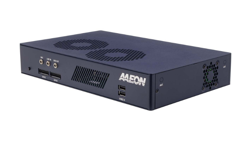

The MEX-BTS features a slim build of just 295 mm x 186 mm x 50 mm for installation in space-constrained applications
The MEX-BTS features a slim build of just 295 mm x 186 mm x 50 mm for installation in space-constrained applications. Image used courtesy of Aaeon

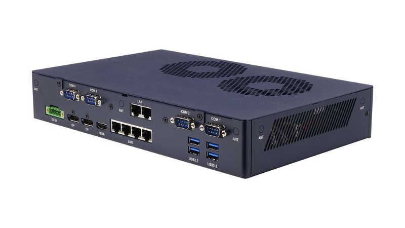

Any good industrial computer will have at least USB, Ethernet, and video out. The MEX-BTS has this and more. Each model is fully equipped with six USB, six RJ-45 Ethernet connections, one HDMI (onboard display), two display ports, four serial ports, and a 16-bit GPIO port. All of these connections make the MEX-BTS modular and capable in various applications.
The MEX-BTS includes six LAN, six USB, and four COM ports
The MEX-BTS includes six LAN, six USB, and four COM ports. Image used courtesy of Aaeon
