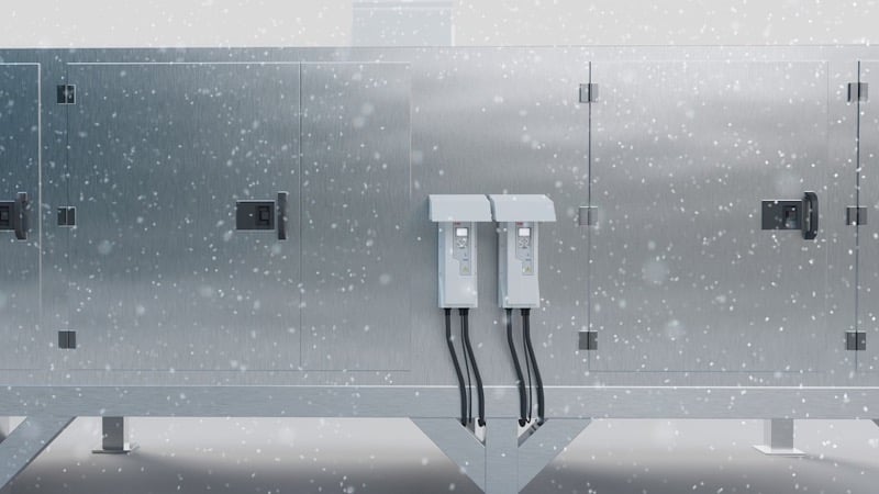

The new ABB ACH580 IP66/UL Type 4X drives are being used to control a rooftop air-handling system.
The new ABB ACH580 IP66/UL Type 4X drives are being used to control a rooftop air-handling system. Image used courtesy of ABB
