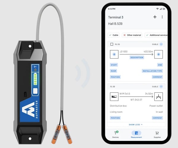

The Aufmaster device and connection illustration. Image used courtesy of HELUKABEL

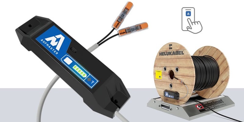

The Aufmaster is a small, battery-operated device that mounts directly on a spool of cable, with the beginning of the cable (at the center of the spool) attached to the Aufmaster. Once turned on, the Aufmaster will connect to the Aufmaster app and determine how much cable is currently attached to the device to be used as a starting reference point.
When a section is cut from the spool, the app will report how much cable was cut and how much remains on the spool. The app can also transmit data to an Aufmaster Plus account where multiple spools can be managed. Each spool can then be inventoried and tracked in real-time, allowing for a more accurate representation and replenishment of current supplies.
The app can also be used to document material usage for specific projects. Labels can be added to cable usage and a customer signoff feature allows for document confirmation.

The Aufomaster device and the app, which tracks the usage and remaining wire length. Image used courtesy of Aufmaster

The Aufmaster works with conductor cross sections of 0.25 to 16.00 mm2 (approx 23 to 5 AWG) and cables of at least 2 conductors with lengths of 10 to 1500 m (approx 30 to 5000 ft). The battery in the Aufmaster is reported to last at least 2 weeks of constant use, and each Aufmaster is IP54-rated. A five-segment LED indicator is used to show the remaining battery life and a single LED indicates connection status.
