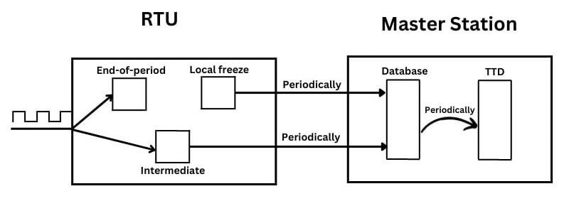

Counter Processing and Supervision for Energy Calculation
The pulses relate to a certain value, generally energy, and this pulse count is connected to a digital input on an RTU accumulating the pulses. Those pulse counter values are transmitted to the master station. The pulses are read at regular intervals on the digital input boards, then at the end of each sample period, all the pulse count values in the RTU are read. The pulse counter values are time-stamped and transmitted to a master station which stores them in a database. The pulse inputs that are blocked for pulse counter values are not scanned or sent to the master station.
The RTU stores only the number of pulses in its database. The master station scales the pulse counter values and stores them in its database for internal use. Then the process-related values like energy are obtained by multiplying the number of pulses with the value represented by each pulse, often called “value per pulse.”
The counter may either be cleared at the end of the period reading e.g. once each hour, or perhaps never as long as the device is not restarted. For supervision, a check is performed to determine that the previously stored values have been transferred before a new reading is stored in the database. In the event of an error condition e.g. faulty input board, the counter values are marked as invalid before transmission to the master station.
Block diagram of pulse counter at RTU and SCADA levels
Figure 2. Acquisition of energy pulse counters from RTU to server
