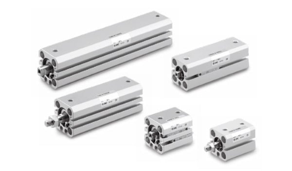

C55 Series - Compact Cylinder
The C55 Series Compact Cylinder from SMC could be useful throughout several automated applications. The series provides more options for manufacturers working in constrained spaces with the addition of bore sizes ø12 and ø16. While these sizes aren't compliant with ISO standards (21287), they offer strong performance for various tasks. The ø20 model benefits from an enhanced anti-lateral load capacity of 1.8 times greater than previous models, which was achieved through changes to the bushing material.
An image of the variations within the C55 cylinder series.
An image of the variations within the C55 cylinder series. Image used courtesy of SMC
One of the standout features of the C55 Series is its extended stroke limit. SMC now offers variations up to 300 mm. Additionally, the C55 Series includes the smooth cylinder variant (C55Y), which operates with minimal pressure starting at 0.02 MPa. This feature allows for stable performance even at very low speeds, as low as 5 mm/s, making it perfect for applications requiring slow, precise movements. Manufacturers will also benefit from the product’s range of customization options, such as the double rod versions (C55W) and specialized models like heat-resistant cylinders and stainless-steel variants. These improvements position the C55 Series as a great tool for industries seeking to improve their automation systems.
