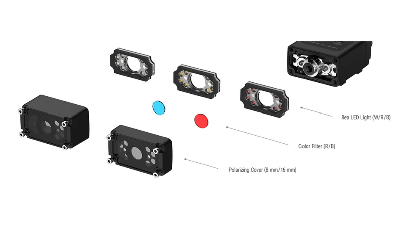

Autonics’ VG2 series sensor integrates the lens and LED lighting directly into the sensor housing with eight internal light sources that support stable image capture even in low-light environments. This reduces the need for external illumination. Users can also replace lighting components, filters, and polarizing filter covers to adapt the sensor to different materials and surface conditions.

Exploded view of the VG2 series vision sensor showing built-in LED lighting, interchangeable color filters, and polarizing cover options
Exploded view of the VG2 series vision sensor showing built-in LED lighting, interchangeable color filters, and polarizing cover options. Image used courtesy of Autonics
