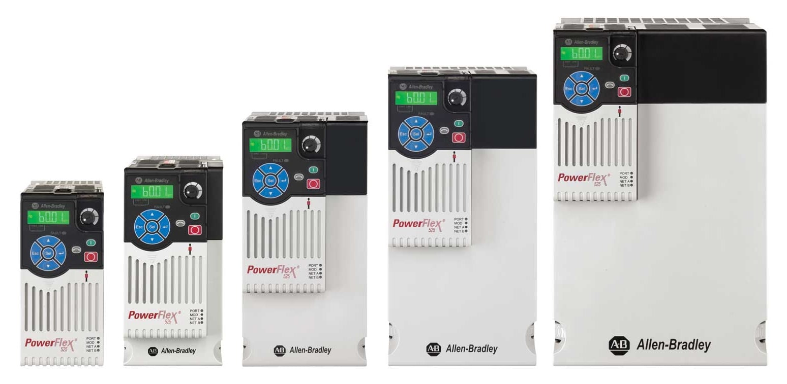

Figure 1. Allen-Bradley PowerFlex 525 Low Voltage AC Drives. Image used courtesy of Rockwell Automation.
The Allen-Bradley PowerFlex line of drives (by Rockwell Automation) is one of the most popular VFD series in North America, and is among the leading manufacturers supplying applications around the globe. The entire Allen-Bradley PowerFlex line includes hundreds of configurations, including size, input/output voltage, and application.
The interface options across the line of drives remain very similar, but for simplicity, this article will focus on the PowerFlex 525 series to avoid any discrepancies there may be between the different models.
This particular family, PowerFlex 525 AC Drives, offers a standard yet modular design with built-in Ethernet/IP communications and USB programming. The 525 series is a smaller drive, but it offers a decent power output range from 0.5 to 30 HP, and input voltage classes from 100 to 600 volts (1-phase for smaller voltages). However, the standard features and functionality provided by this drive family are huge.

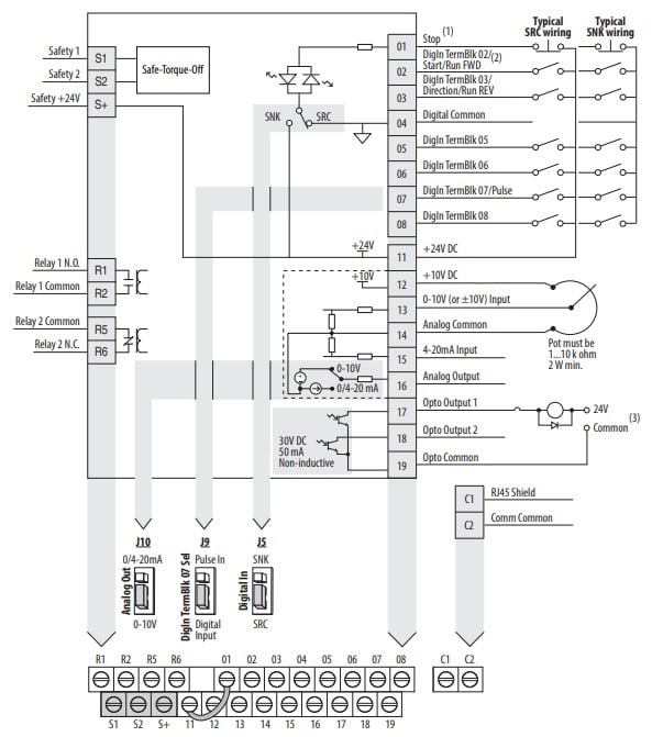

Conventional Hard-Wired Control
Although networking is the modern standard, the PowerFlex 525 drive does include all of the conventional hard-wired control options, typical of most variable frequency drives. This can be used as a primary or secondary control backup option to Ethernet/IP control with the proper configuration.
Control I/O wiring for powerflex drives
Figure 2. PowerFlex 525 Control I/O Wiring Block Diagram. Image courtesy of Rockwell Automation.
The hard-wired control options include start/stop functions, direction control, and auxiliary digital inputs that can be programmed to pre-select ramp rates and/or speed setpoints, to name a few. There are also hard-wired analog input and output options, like most other drives.
Analog options include 4-20 mA, 0-10 VDC, or potentiometer inputs along with 4-20 mA or 0-10 VDC analog outputs. The PowerFlex 525 also includes safety-rated inputs for emergency/safety trips.
If you are only interested in starting and stopping a motor and controlling speed once ("set it and forget it"), this conventional hard-wired control may be enough. However, suppose you want to access more features and take advantage of the integrated programming and monitoring with a ControlLogix or CompactLogix controller. In that case, utilizing the standard built-in Ethernet/IP communications is almost certainly the way to go.
