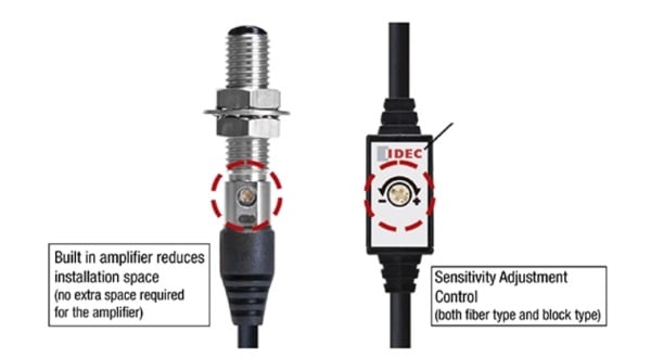

What makes this sensor a little more special than the rest? The SA1N photoelectric sensors boast a length of only 3cm. These sensors, however, also feature a built-in amplifier, removing the need for an additional unit. These photoelectric sensors also come equipped with a 2 m flexible cable, which sounds odd for a photoelectric sensor because you would normally think that these cables would be an inflexible photoelectric cable. However, this sensor uses a stainless steel fiber-type cable, which allows the cable to be flexed and makes it easier to replace if damaged.
The SA1N will feature a built-in space-saving amplifier and a sensitivity adjustment control.
The SA1N will feature a built-in space-saving amplifier and a sensitivity adjustment control. Image used courtesy of IDEC
The SA1N sensors will feature two different styles of photoelectric sensors: barrel-mount and block type. The barrel-mount sensors will use a fiber-type diffuse-reflective infrared-style LED and be secured with an M6 nut through the mounting hole. The barrel style will also have a sensing range of 3 to 50mm. The block-style sensor is a convergent-reflective red LED style that has a detection range of 5 to 50 mm and can be secured through the two mounting holes, which will have a 14 mm pitch. Both models will have PNP and NPN light-on configurations and will have response times as fast as .5 msec. Each sensor is also equipped with a sensitivity adjustment volume, which can be set according to the user to increase the flexibility of their sensor installation depending on their workpiece and distance.
