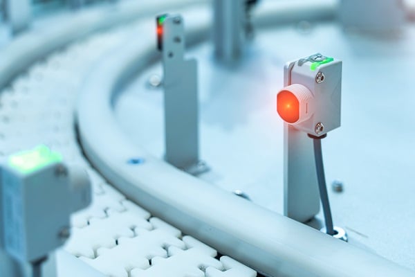

The term “light-on,” sometimes called “light operate,” simply means that the output signal will energize in the presence of a beam of light. As we know from other articles about photoelectric sensors, there are three types: through-beam, retro-reflective, and diffuse reflective. All three varieties are designed so that the presence of light must be strong enough to trip the detection circuit and output a signal.
 Figure 1. All photoelectric sensors will specify if the output is active in the presence or the absence of light.
Figure 1. All photoelectric sensors will specify if the output is active in the presence or the absence of light. Image used courtesy of Adobe Stock
When we select a light-on mode sensor, we can interpret this to mean that the output signal will be energized only when the beam of light from the emitter device or the retro/diffuse reflection exceeds the threshold mark.
This terminology does not override or negate the PNP/NPN output polarity. A PNP output signal may energize when light is present. Similarly, an NPN signal can also energize when light is present. Sensor specs will report both the polarity and the light/dark mode.
