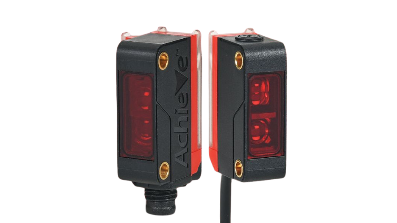

The AchieVe FBM series photoelectric sensor is available in several sensing styles. Diffuse with background suppression, polarized retroreflective, and through-beam styles allow engineers to design their automation system around their needs rather than an optical sensor's limitations.
AutomationDirect's AchieVe FBM photoelectric sensor series offers sensing distances up to 10 m
AutomationDirect's AchieVe FBM photoelectric sensor series offers sensing distances up to 10 m. Image (modified) used courtesy of AutomationDirect
The sensors can be used as a "break beam" system, where two sensors are placed opposite one another. When an object passes between them, the light beam is interrupted, and the object is detected. In other cases, the reflection from an object is what is recorded.
One specific example is the use of a diffuse sensor with background suppression, which may be required when a sensor faces a reflective background. For example, consider a production line in the food and beverage industry, where most components are made of stainless steel. The stainless steel is reflective and can reflect ambient light into the sensor or reflect the sensor's beam back into the sensor. Either case is unacceptable. The AchieVe FBM has a background suppression system that discards these reflections and only counts the reflections of interest.
