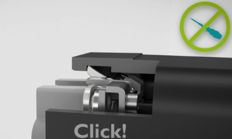

Tool-Free Assembly Inside the Connector
The Clever-Click carrier frame is built around a simple mechanical latch. Modular contact inserts are pressed into the frame until an audible and tactile click confirms proper seating. The same click-in action is used to secure the assembled frame into the connector housing. No screws. No torque checks. No special tools.
The Clever-Click system can minimize your typical manual steps in connector assembly, such as soldering individual wires, while also reducing the number of knockouts required for different types of connections. The latch feedback clearly indicates when the insert is fully seated, reducing rework and installation errors.

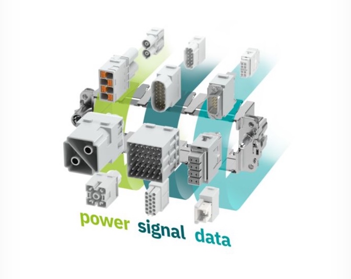

The Clever-Click frames are designed for use with HEAVYCON modular contact inserts, allowing power, signal, and data modules to be combined in a single connector. This allows each connector to be tailored to the application rather than relying on fixed layouts.
A single HEAVYCON connector can carry power, signals, and data using modular or fixed-position inserts.
A single HEAVYCON connector can carry power, signals, and data using modular or fixed-position inserts. Image used courtesy of Phoenix Contact
The power modules are rated for currents up to 300 A, making them suitable for energy storage systems, server racks, and other high-current industrial equipment. That same connector can also handle low-level signals or data lines, reducing the number of separate interfaces needed. When a modular layout isn’t required, Phoenix Contact offers fixed-position contact inserts that use the same click-in latching approach. These versions fit standard HEAVYCON EVO and STANDARD housings and keep the same tool-free installation process, just in a simpler, fixed layout.

An audible and tactile click confirms the carrier frame is fully seated in the HEAVYCON housing.
An audible and tactile click confirms the carrier frame is fully seated in the HEAVYCON housing. Image used courtesy of Phoenix Contact
