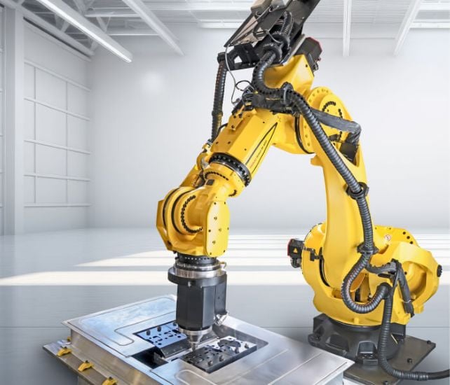

FANUC’s new M-950iA is a heavyweight robot that features a 500 kg payload and 2,830 mm reach.
FANUC’s new M-950iA is a heavyweight robot that features a 500 kg payload and 2,830 mm reach. Image used courtesy of FANUC

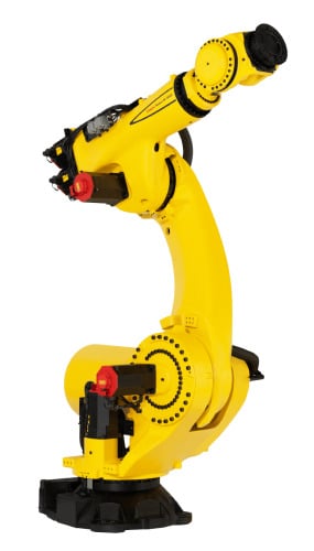

FANUC’s M-950iA/500
The obvious major feature of this robot is its high lifting capacity. Lifting 500 kg at a time is no easy feat, but is one that is becoming necessary with more and more vehicle manufacturers switching to electric over internal combustion engines. While the small block 350 may weigh in at 560 lbs or so, large battery packs found in EVs can be much heavier. To be able to handle them safely and efficiently, a stronger robot than even those lifting the engine blocks of the muscle car era are required. This is where the new M-950iA/500 industrial robot enters the ring.
The M-950iA features a serial-link mechanism that enables it to rotate its arm straight up and “bend” backwards.
The M-950iA features a serial-link mechanism that enables it to rotate its arm straight up and “bend” backwards. Image used courtesy of FANUC

Simply lifting a heavy load is not enough. The M-950iA can also manipulate it along six axes, including the ability to flip its arm backward along the J3 axis and reach as far away as 2,830 mm (a little over 9 feet). Extra strong wrist joints help provide this wide range of motion. The robot also uses serial-linked components instead of parallel-linked components, making more motion options available. Typically, heavy-lifting robots use a parallel link mechanism, so the serial link helps set the M-950iA apart from other robots in the FANUC line.
The reinforced wrists also make the robot a stiff working platform. Motions are repeatable down to 0.08 mm (0.003 in). The high accuracy also makes it possible to perform other precision tasks that can rattle other robots, such as friction stir welding, drilling, and riveting.
