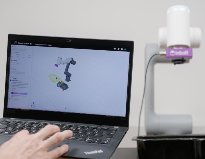

Two important features for any robot application are speed and flexibility. Inbolt's bin picking solution advertises a processing time of less than one second. Inbolt Studio is the programming software where technologists can teach vision models and train the AI algorithm for the most efficient bin picking possible.
Flexibility in a system allows machine builders to implement it across different processes with minimal changes. With the camera mounted on the robot arm, the bin size and shape can change without affecting the inspection process.
Inbolt Studio being used to teach vision models
Inbolt Studio being used to teach vision models. Image used courtesy of Inbolt
