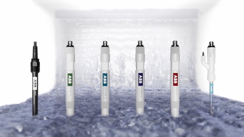

The pH sensor family has a different design and color-code for different applications.
The pH sensor family has a different design and color-code for different applications. Image used courtesy of ABB
ABB’s Expanded pH and ORP Sensor Portfolio
The 500 X sensor is part of ABB’s broader range of pH and ORP measurement devices for various process needs. The 100 Series, which includes the 100E, 100GP, and 100 ULTRA, is often used in drinking water, wastewater treatment, aquaculture, and irrigation. These entry-level sensors are designed for routine conditions and prioritize affordability and reliability.
The 500 Series, including the 500 X and 500 PRO, is built for tough industrial and marine environments where sensors are exposed to extreme heat, fouling, and corrosive conditions. These sensors use ABB’s most durable electrode design, making them ideal when reliability under stress is critical.
ABB’s 700 Series is made for specialized measurement needs. The 700 ULTRA is a rechargeable sensor designed for very precise readings in low connectivity environments, making it ideal for high-purity water systems and other applications that require exact chemical control.
The new sensing solutions feature easy-to-identify color-coded design systems that map each sensor to a specific application. A range of universal accessories supports installation across different process environments.
