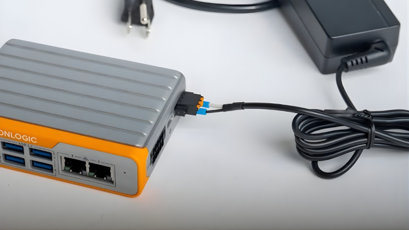

Saving room in an electrical cabinet can help keep heat production down and reduce overall costs. The CL260 is ultra-compact, operates on 12 VC to 24 VDC, and doesn’t produce much heat. With the DIN rail mounting option, users can mount the IPC just as easily as other electrical components.
The CL260 utilizes a 12-24 VDC three-pin terminal block for power input
The CL260 utilizes a 12-24 VDC three-pin terminal block for power input. Image used courtesy of OnLogic
