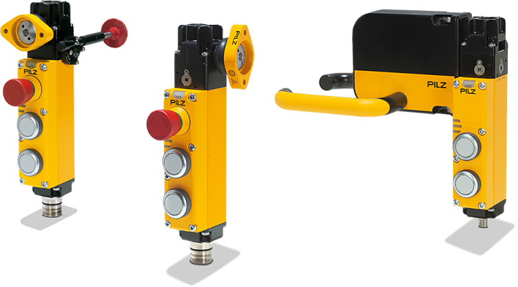

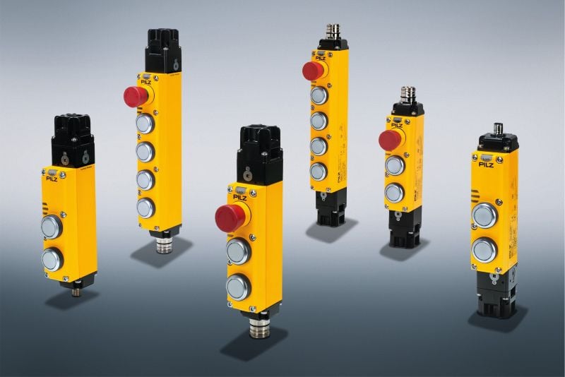

Not all machines are created equal; some machines need to have special features due to the process or just a customer request. For those who use the PSENmgate safety system, there are now more options. The original PSENmgate models have two pushbuttons and are integrated with PSENmlock from Pilz. New variants now have space for up to four push buttons or key switches, along with the ability to add an emergency stop button. The button can be configured to be illuminated or standard, and all the inputs are pre-wired to industry safety standards.

The overall footprint typically defines how operators will access the equipment. Some situations call for sliding gates, while the standard swing gate is often very popular. The additions to the PSENmgate allow for two different styles of handles; the new style is geared toward swing gates and comes in two different styles.

New versions of the PSENmgate also allow installation within existing equipment, thanks to the addition of upward cable routing. This feature, along with the pre-wired input controls, is intended to save integrators time during commissioning. When features are not working, users only need to troubleshoot at the cable end.
