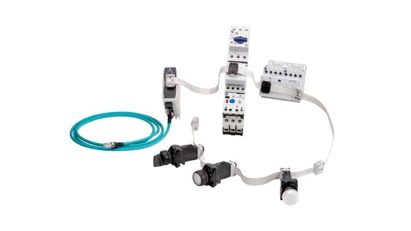

The in-cabinet Ethernet IP system can simplify wiring and prevent common human errors when compared to traditionally wired systems.
The in-cabinet Ethernet IP system can simplify wiring and prevent common human errors when compared to traditionally wired systems. Image used courtesy of Rockwell Automation

The in-cabinet solution consists of a gateway, flat media cable, and communication interceptors.
The in-cabinet solution consists of a gateway, flat media cable, and communication interceptors. Image used courtesy of Rockwell Automation
With Rockwell’s In-Cabinet solution, a 7-conductor flat media cable connects components via Ethernet/IP protocol, which means all devices share the same network for both power and communication, creating a backbone that’s easy to scale and maintain. The single-pair Ethernet cable reduces material costs, space requirements, and the environmental impact of excessive copper and plastic use.
