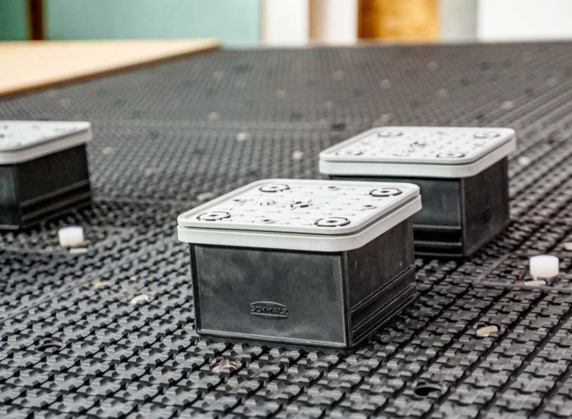

The automation solutions expert Schmalz announced the release of two innovative vacuum blocks, the VCBL-R and VCBL-N, for grid and nesting-based computer numerical control (CNC) wood processing applications. Depending on the desired use case, both vacuum blocks can be used interchangeably between grid and nesting tables. Adding or removing a nesting insert reduces time and manual labor when switching between applications. The flexibility offered by this functionality is intended to save woodworkers valuable time, reduce material waste, and improve production.
According to Schmalz, the laborious and time-consuming task of modifying setups when switching from grid tables to nesting tables during CNC wood processing is over.
According to Schmalz, the laborious and time-consuming task of modifying setups when switching from grid tables to nesting tables during CNC wood processing is over. Image used courtesy of Schmalz

The key draw of Schmalz’s upgraded vacuum block series is the ability to switch from grid to nesting table via adding or removing a nesting insert. Tedious manual intervention must be performed to switch between suction cup-based grid clamping and sheet-vacuuming nesting fastening. To maintain pressure, technicians have to remove and reinstall suction cups when transferring between processes, position them for particular product layouts, and seal any unneeded vacuum zones. The complexity and time needed for setup modifications may increase if the CNC machine needs to be reset due to variations in elevation and flatness between grid and nested setups.
Schmalz’s VCBL-R and VCBL-N vacuum blocks provide a membrane-coated suction plate to protect parts.
Schmalz’s VCBL-R and VCBL-N vacuum blocks provide a membrane-coated suction plate to protect parts. Image used courtesy of Schmalz
Using vacuum blocks that can fluidly transition between grid and nesting tables can increase productivity by minimizing the need for human interaction. Operators can transition between grid fastening and nesting more rapidly because of these blocks' quick repositioning and adjustment capabilities, eliminating the requirement for complete removal and reconfiguration. These blocks simplify setup, remove the need to seal unneeded zones, and reduce downtime by automating vacuum zone control and sustaining suction in all necessary places. As a result, the process becomes more effective, enabling faster transitions and increased throughput for CNC operations.
