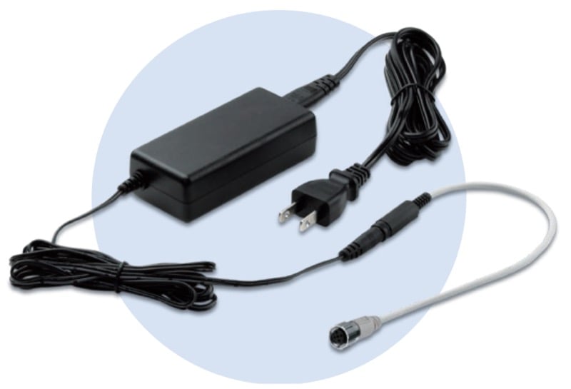

SMC introduced an AC adapter that lets technicians power and bench-test M12 devices before installing them in an automation system. Available in two models, the adapter supports 120/240 VAC input and provides up to 1 amp of output through a prewired M12 connector, eliminating the need for improvised wiring or a dedicated industrial power-supply setup. Machine builders, controls engineers, and maintenance technicians can use the adapter to configure devices, test parameters, troubleshoot equipment, and prepare wireless products before installation.
The AC Adapter from SMC.
The AC Adapter from SMC. Image used courtesy of SMC

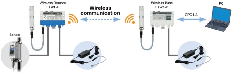

Whether you are a machine builder, maintenance engineer, or automation DIY’er, bench testing sensors can shorten integration time. Connecting your new sensor without installing it in the system lets you test different settings and parameters and debug control code. When troubleshooting a sensor that isn't functioning, being able to apply power safely and quickly can help reduce downtime. SMC has recently released an AC adapter with an M12 connector already wired. This adapter is designed for many SMC products and doesn’t require sketchy wiring.
Using the AC adapter to set up wireless devices before installation.
Using the AC adapter to set up wireless devices before installation. Image used courtesy of SMC

The SMC AC adapter comes in two models: A corded model supporting voltages up to 125 VAC and a cordless model that supports higher voltages. The adapter itself is compatible with 120 / 240 VAC at 50 or 60 Hz. Resembling a laptop charger, the AC adapter is basically a bench testing device that some people might make themselves; the difference being that the adapter from SMC is professionally built, comes with an M12 connector that works with SMC products already installed, outputs the correct voltage, and offers up to 1 amp of output current.
