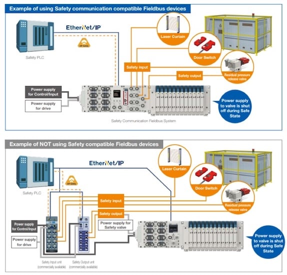

CIP safety over Ethernet/IP has been used for many years now, especially with servo drives, to transmit safety communications over the popular industrial Ethernet network, EtherNet/IP. The new EX600 safety fieldbus module allows system designers to place safety I/O directly in the field near the actuators, valve banks, and systems that require them.
A typical installation of a pneumatic valve bank on a machine will require a constant 24 V DC source and a switchable 24 V DC power source. This switched power is routed through a set of safety relays that are energized with a safety output, and the state of the relays is monitored with the safety inputs. This topology requires extensive wiring and cabling from the main panel to all valve banks on the equipment.
With the EX600 safety fieldbus system, only 24 V DC and Ethernet communications are provided to the EX600. When a safety output is commanded off over the CIP protocol, power to the external output and/or valve bank is turned off, thus eliminating the need for safety relays and panel safety I/O systems. The EX600 uses a dual redundant output method and monitors the state of the outputs for constant diagnostics.
Two systems, one using conventional safety I/O and the other using the EX600 safety I/O.
Two systems, one using conventional safety I/O and the other using the EX600 safety I/O. Image used courtesy of SMC
EX600 Safety Communication System
The safety module has a safe input and output module comprising 16 safety inputs and up to 2 external safety outputs. One output is used for internal safety control of up to 32 solenoid pneumatic valves; an upgraded model allows for up to 128 solenoid valves. The safety inputs can be used to check residual pressure in the system or light curtains. They can be configured as single or dual inputs, with dual reducing the total inputs by half.
