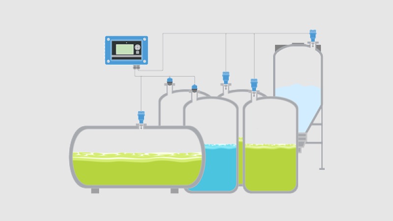

The Rosemount 2405 combines the roles of display, data concentrator, and communication gateway. Instead of forcing the user to install and integrate multiple pieces of hardware, the hub serves as a complete inventory point for up to eight tanks. It collects level, temperature, and pressure data from HART-enabled field transmitters. It then consolidates that data into a clear picture of tank status, accessible both locally via a color field display and remotely via a built-in web server. For operations that have struggled to justify the cost and complexity of automated monitoring, this all-in-one architecture significantly lowers the barrier to adoption.
The Rosemount 2405 Monitoring Hub provides local access to live tank and inventory data through its integrated field display.
The Rosemount 2405 Monitoring Hub provides local access to live tank and inventory data through its integrated field display. Image used courtesy of Emerson
A Single Hub for Multi-Tank Insight
What sets the Rosemount 2405 apart is its ability to function as the centerpiece of a simplified monitoring architecture. Because it supports HART multidrop communication, multiple instruments can share a single twisted-pair cable. That alone reduces wiring requirements, minimizes the number of junction boxes and input channels, and removes many of the installation bottlenecks that historically made tank automation expensive.
The hub does more than relay raw measurement values. It performs the calculations needed for inventory reporting, including volume, utilization, rates, and other metrics that operators use to plan production, schedule deliveries, and forecast consumption. By consolidating data from several tanks into a single device, it eliminates the patchwork of interfaces that often complicates inventory management and creates gaps in situational awareness. Plants that previously depended on clipboards or occasional manual readings can move toward continuous, real-time oversight with a relatively modest system upgrade.
The Rosemount 2405 serves as a central data concentrator for multiple HART-enabled instruments, simplifying wiring and consolidating tank measurements.
The Rosemount 2405 serves as a central data concentrator for multiple HART-enabled instruments, simplifying wiring and consolidating tank measurements. Image used courtesy of Emerson
